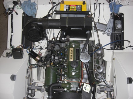

My story about the tach drive is that I had heard the same information you gave Kurt, that the original gearbox units last, while the reproduction ones do not. So I searched for a factory one, found it, paid about $75.00, and relubed it. Put my engine in, buttoned up everything, then pulled the starter cable. Engine started, standing in front, reached down with a screwdriver to increase the idle speed, and a terrible sound occurred, and I saw something fly across the garage to my left, no more than 12" from my head! I ran to the dashboard, and turned off the key, but the engine did not shuck off. Then ran around to the coil and pulled off the 12V supply. So what had happened, the tach gearbox had seized, the generator now turning the gearbox and the tach outer sheath. Once enough turns, the gearbox unscrews from the generator, and it was projected into space. The tach cable was twisted like wet spaghetti. A wiring error with the generator light had prevented beeing able to turn the engine off with the key. I purchased a Moss units, as it has a warrantee for 2 years. One year and counting!
Scott in CA

Sorry to hear that! Did it just come loose or did the cable seize or what??
I'm running an original on my BE with original cable. When I got the car PO had fitted a new replacement which failed the first year. With the car came a box of parts that included another junk new replacement(gears shot) plus a original that the pinion would work out of. I put a piece of rubber in the drive hole in the gen to hold the pinion and used some blue locktite to hold the gearbox to the gen. Still using it with no problems several years later. I did pull the cable out of its sheath cleaned everything with solvent then let the cable soak in oil in the bottom of a 5 gal bucket. Very little effort to turn the tach now.

Very nice looking engine compartment, Scott. I imagine the rest of the car looks great as well!
