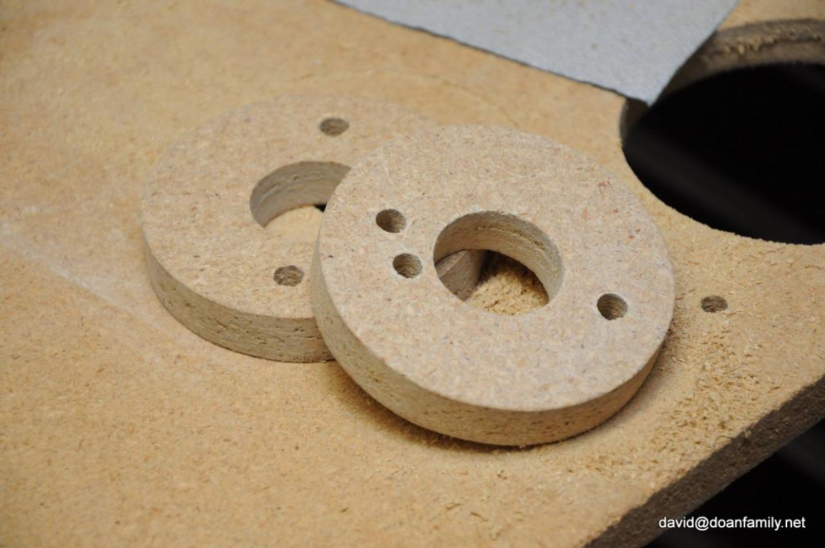

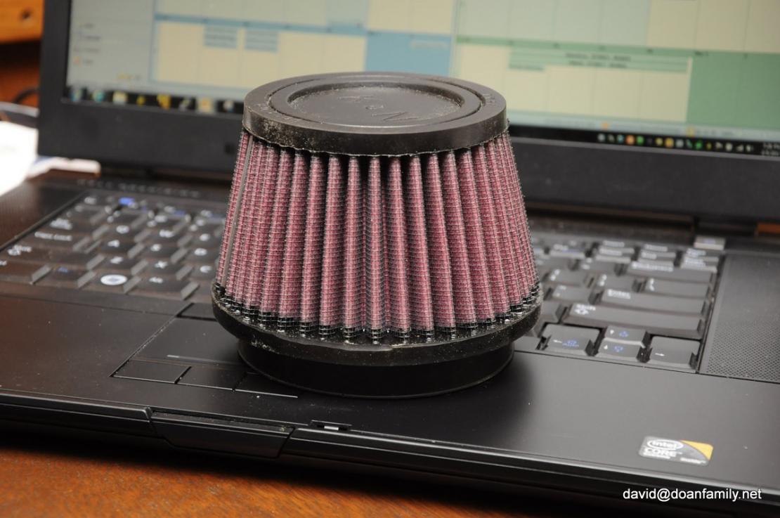

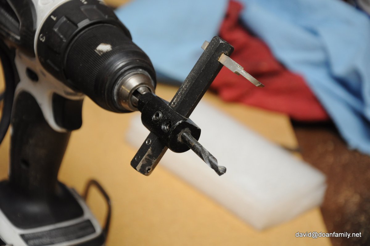

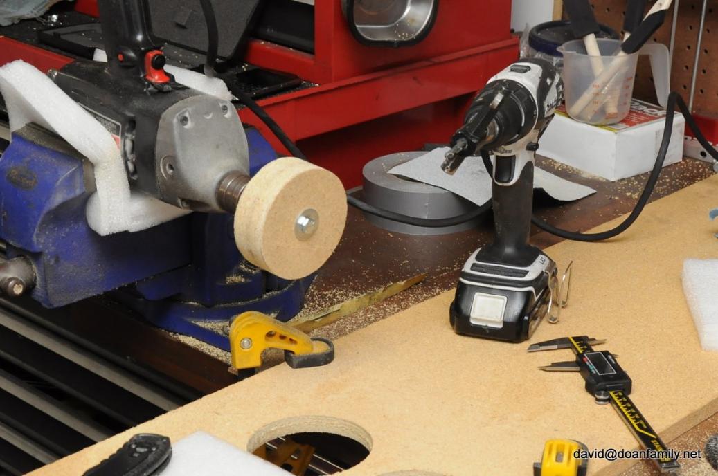

I've seen pics of these air filters on HS2's but could not find anyone that sells the stub stacks to make it work. So, tonight after work I made my 1st prototypes out of 5/8" particle board. I don't have a 3.5" hole saw so I used a really cheap adjustable single blade hole saw. I cut both slightly too big, then mounted them in my redneck-lathe to clean them up and sand them smooth. Then I used a 1.25" hole saw to cut the center hole. I'm going to give them a few coats of sandable primer and paint them with engine paint to seal them up. They would probably perform slightly better with a radius on the center hole, but the breather hole is too close to do that with particle board. If these work well, I think I will eventually make them out of plastic. For now, it is a basically free way to get rid of the ugly stock air cleaners.

I'd be afraid that the vibration would cause the particle board to flake and get sucked into the engine. Maybe you should go ahead and make the plastic version.
...or ask Gerard if he'd like to talk his machinist into doing a batch in aluminum for a reasonable fee.

This is something I've also been interested in. I'd also like to run the RU-4410 filters, but I also need those stacks to make it work. I plan on trying the K&N 56-9335 filter with my billet stub stacks from APT.
https://www.aptfast.com/showitem.aspx?id=101220&name=H2%2FHS2%20%281-1%2F4%22%29%20Billet%20Stub%20Stack&
The K&N 56-9335 should just bolt on to any HS2. I was going to get those but I really like the looks of the 4410's and they're only $27 on amazon. Also easy to make adjustments with the 4410's on.

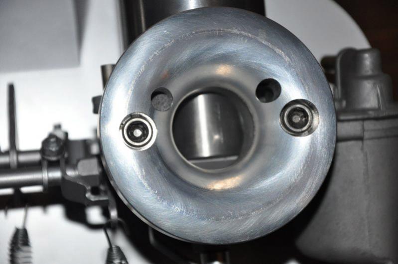

Here is a closeup of the velocity stack. Maybe gives an idea as to the radius work.

Hey guys, I've just have too much going on to sink money into making these, you can get them from MED Engineering in the UK . David pictured stacks above , was my last set I had in stock. David , sorry for not returning your email/pm, sometimes I get covered up with emails/pms and might have missed your message.
