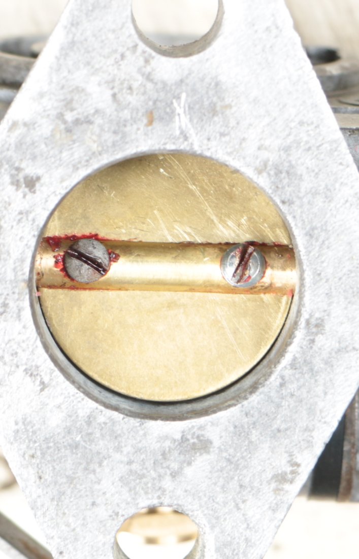

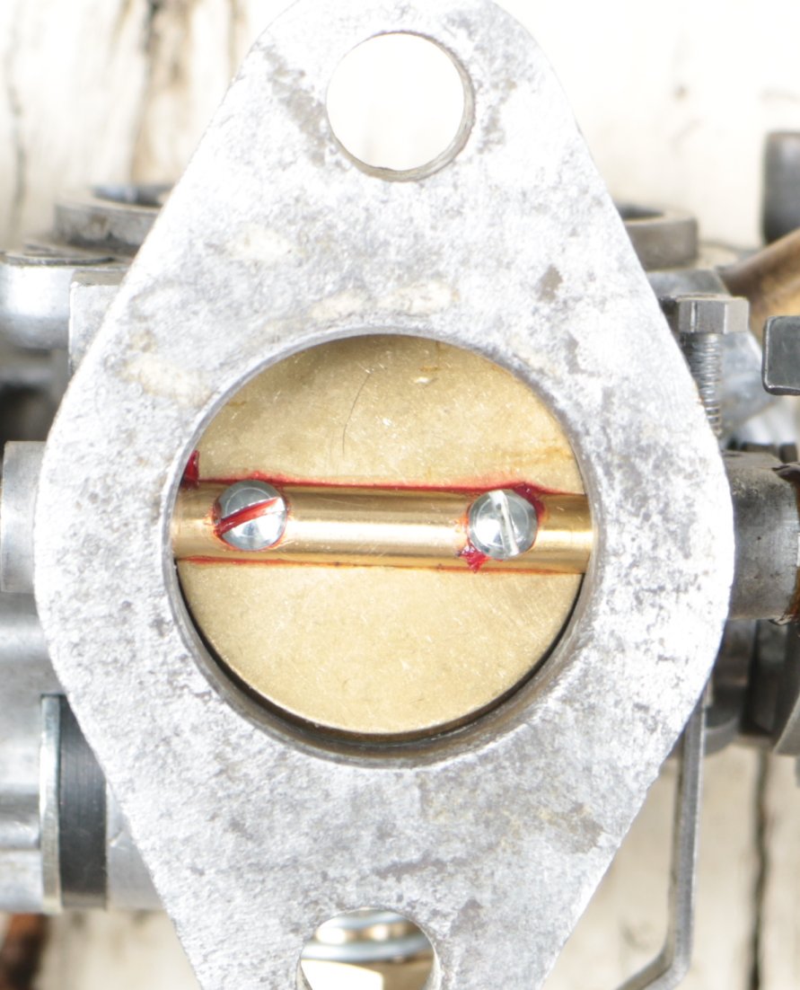

Do i need to rework the throttle plate as it does not close all the way. about 10 thousandth gap on one of them.
Is this too much for a good Idle?
smaceng
Try to loosen the butterfly screws and re-position the butterfly for a better closing.
Scott in CA
drooartz
Yes, the butterflies should seal up tight. Scott's idea is right on. I had a similar issue on the HS4 on my previous MGB -- one butterfly didn't seal correctly and that carb just would not idle down to even close to where it was supposed to.
Loosen those screws and get them to seal.

Thanks for the good advice. I now have them where they should be. now I think I can get them adjusted properly
