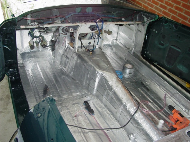

no smell with Fatmat, 100 sq. foot will do the entire car. For best results put 3 layers on the drivers floorboard and transmission tunnel. BTW, the grey color on the door face and insides as well as behind the dash in the attached picture is Liquid Fatmat a brush on insulation with the consistency of mud.
