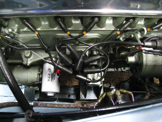

Hi Randy,
Have you considered using Pertronix wires? I have a set on my car.
Pertronix
