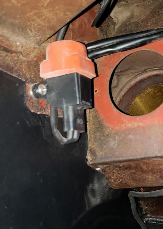

I used this one for the fuel pump only (that's how folks usually wire it). Mounted it next to the wiper motor so it would be easy to reset. Been running it for about 6 months without having to reset it. I spliced it into the pump wiring at the firewall connections. Works fine except the connector is wired incorrectly, but easy to fix - how-to details in Amazon comments.
