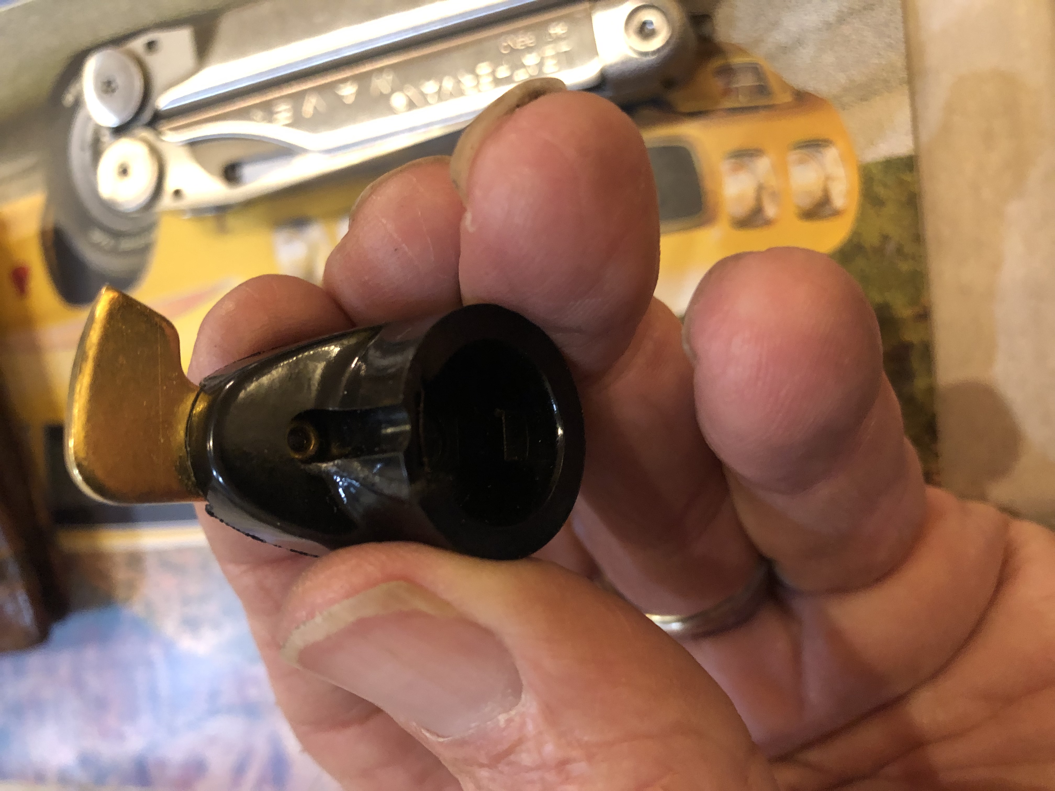

Anyway, when I got home, I took a close look at the router. You can clearly see that there is a burn track where the spark was moving from the center of the rotor, from the river, and down the rotor body onto the distributor plate or shaft. I would never have believed it….
OBTW: This is the Lucas / Moss Motor “upgraded” rotor! Stick with the red ones!

Sarastro
That's the problem in dealing with high voltages--they can be hard to contain. Whoever designed that rotor figured that there was enough spacing between the rivet and the distributor shaft to prevent arcing, but obviously there wasn't. A little moisture, a little crud on the rotor surface, or a crack, and voila--a path for a spark.
That rotor is a flawed design. The rivet should be deeply embedded in the plastic. Other rotors don't use a rivet at all and instead the brass piece itself is partially embedded in the plastic. Much better.
R

Rocky_LC
Actually, now that I’m looking at the packages, the “premium” rotor is the red one without the exposed rivet.
The black one is the bad one with the electrical path to ground.
(And I know the red one (on the right) has a crack through it, but there’s a brand new one inside the white package)!
I couldn’t figure out how to edit my first post, but I thought I’d better correct myself if anyone is looking for parts.
