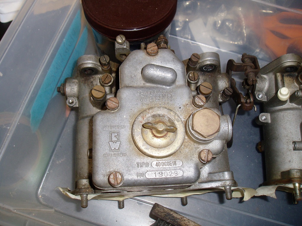

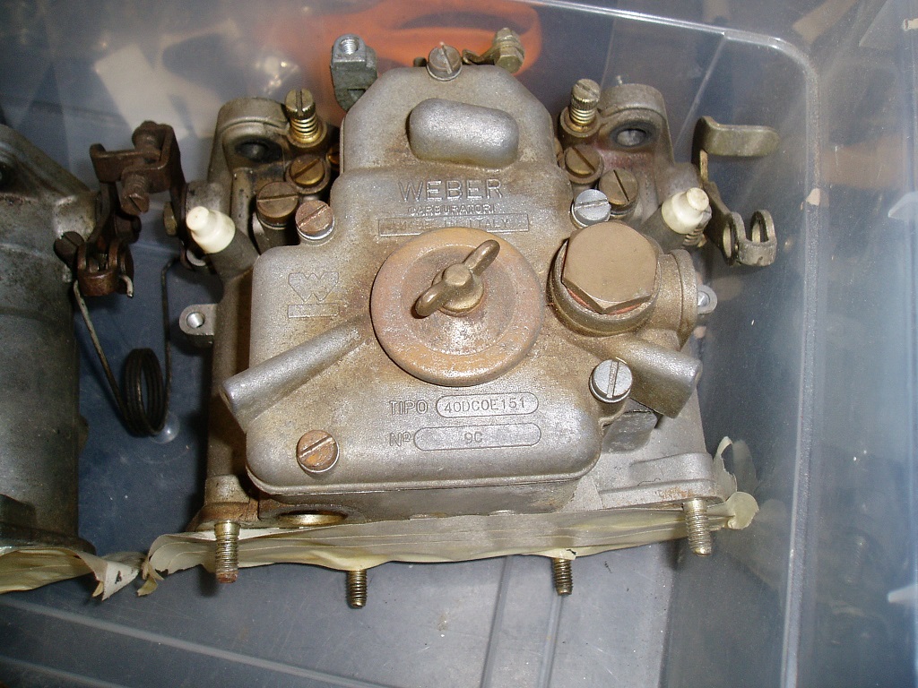

My Plus 2 S Elan is undergoing a chassis transplant, so perhaps a good time for a carburetor tune up. On close examination I find that there are 2 different Weber 45 DCOE on it. As far as I can tell, the car had two Strombergs originally and the Webers were added by the PO some time in the distant past.
As seen in the photos, the top covers are slightly different as are the numbers. (40DCOE 18 vs 40DCOE 151).
Question then Does it matter?

Does it matter? I do not have a definitive answer on that, here is what I can tell about the two different carburetors that are on the car. The 40 DCOE 18 is an Italian made Weber AFAIK and would have been either a non North American market fitment or semi-shady (emission controls related) dealer installed option of part of a conversion done by a previous owner or shop of previous owners choice. The 40 DCOE 151 is a Spanish made Weber and happens to be the only 40DCOE currently in production from Weber. It looks like most of the jets and main venturi are interchangeable, but the auxiliary venturi and the the floats are not. The float setting is done differently between the two but needle and seat are the same basic part number, but like the , venturi, jets and emulsion tubes, you will have to make sure that whatever is fitted matches from carburetor to carburetor.
Here is an early 40DCOE manual and parts list that would cover the 40 DCOE 18 as well as 40 DCOE 151 parts list to review for part differences between the two. My personal opinion is that you should run a matched set so all of you set ups match. Unless you are going for a concours winner either unit paired together looks like it would work. If you are thinking concours winner, you need 2 of the 40DCOE18.
Classic Motorsports has had two sets of 40 DCOE 18 carburetors restored in the last few years one set at Pierce Manifolds, the other at Weber Carburetor Restoration. If nothing else you might try contacting Frank Filicicchia of Famous Franks Lotus Parts. Carburetors are really outside of what he does but it wouldn't surprise me to find out that he knows of someone he could recommend.

I thought I would hold up until the good Dr. had a chance to chime back in on possibly having a DCOE18 sitting around. We now have that answer so here is my take on things if I ran the zoo or asylum, take your pick.
I would want a matched set of carbs, if you can find a more period correct DCOE18 and then have it and your existing DCOE18 rebuilt by a Weber Specialist such as Mike Pierce at Weber Carburetor Restoration, that is probably the best answer:
And even though carburetors are outside his normal part of the Lotus spares and restoration parts business, I can't help but think that it would not hurt to check in with "Famous Frank" to see if he has any thoughts on Weber rebuild and restoration service providers.
The other option would be to double check you existing 40DCOE151 to make sure it is a Spanish* built unit with the plastic floats and either have it rebuilt and mate with a new 40DCOE151 or just buy a pair of brand new Weber 40DCOE151s (not some of those knock offs that are floating around out there on the interwebs) and have them set up for your car. Above I had stated "the theory of operation for both are essentially the same" with essentially being the key word. The 151 was sort of developed to be a more emission friendly unit and the differences in operational theory are primarily tied to the way the progression circuits are set up and that is one of the tie ins that DrEntropy is alluding to when he mentions the white plastic caps and the air by pass screws. I have heard that some people that have altered the progression holes in the 40DCOE151 to make them more like the 40DCOE18 or 40DCOE2, but personally do not know anyone that has done so. I know that I don't have the type of equipment to want to try such a thing.
Here's another rabbit hole to head down. Figure 11 shows an idle enrichment hole and figure 12 shows the idle enrichment screws, note what they say about different screws having differing tapers. Figure 22 shows the progression holes in the bore of the carburetor while figure 23 shows the progression holes from the access port on the top side:
* Rumor central has it that there were supposedly some very early on Bologna built 40DCOE151 carburetors, but every 40DCOE151 I have ever seen was Spanish built.

I would be curious as to which float is in the 151 Tom has. The cover is stamped "Made in Italy" so it may be one of the rumored Bologna units.

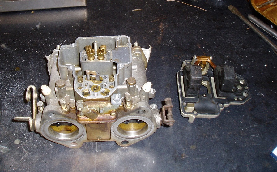

I don't know how definitive the plastic float is but here it is:
