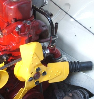

Question... After the install of a Weber, I find that the heater pipe is hanging loose under the carb. I'd like it to be next to the valve cover and a straight shot from the heater. Does the cooling system need to be drained, and would the older generation pipe fit using a union from the radiator hose?

The earlier pipe that fits to the valve cover will work. I use the one with the tabs welded to the pipe.
Best to drain a little coolant to avoid any spillage.

For those that are reading this with early Bs, you may fit the later version of the hose from the water pump to the heater pipe/ radiator and remove the iron elbow and hoses/clamps and simply the job.

Having restored many T series cars, the short hose with the cast elbow is a PITA to service once the car has panels fitted and done some miles.
My B did have the same setup, but was switched out some 45 years ago.

I just looked up the elbow I think you were referring to on the MGA page of Moss. The elbow and the copper (brass) parts look like a possible answer...

The early MGB's (pre-'68) had the same arrangement.

Yes, that same part was used on the MGA as well. They went to the molded and bonded one piece lower hose in 1972 (GHN/GHD5UC group of car serial numbers) with the introduction of the 18V engine series.

Current arrangement in our '64 when undergoing rebuild. Cheaper/easier to keep the three pieces of hose in the "onboard spares" kit than that three-way thing as well.
