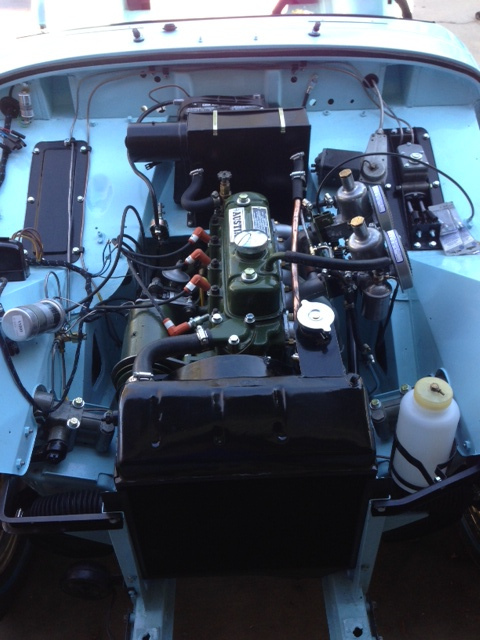

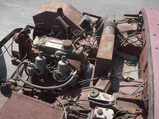

After 35 years we finally have startup. Thanks to my uncle and all of you we were able to get her running today. Just a reminder of what she looked like when Doug M told me about her......
Carbs need some adjusting and we need to do more of the wiring and fix the oil leak from the spin on oil filter!
The car came with a spin on oil filter with poor rubber O-rings. In my haste I for got to change them and now it is leaking. Any ideas about what size O-rings they are and where I can get them?

Looks nice Paul and you should be able to get an O-ring to fit at any hardware store or farm supply store.

That's always a neat feeling bringing something back to life that someone else had written off. Congrats!
Quite the transformation! Makes me feel like I'm cheating with my project. :grin:
Nice work, much to be proud of there.

WOW, what a transformation! You have done some beautiful work, more pictures!
