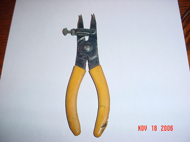

I'm sure there's a spanner that is made to tighten the nuts on the dash that hold the light switches and ignition, but I don't happen to have one. I lent it to Anthony and he never gave it back. Something about his dog eating it.
So if you don't have the correct spanner, any alternatives that won't scratch the nut and will apply even pressure? Thanks.
A pair of fine needle nose pliers aimed head on works just fine if you have a steady hand. A set of snap ring pliers works even better. See attached pic.

Thanks Dave. I lent Keoke my snap ring pliers, so I'll just have to give it a go with my needle nose and hope that I'm having one of those steady hand days.

I too used a needle nose plier. The end of the pliers had a 45 bend, which helped avoid the shaft. Two hands. One to keep pressure, the other to keep the two tips in the small groves, while trying to turn. Yhea, that's easyer than it sounds.

Go to flea markets. I got too different size circle/ring clip removers for a buck. They have the 90 degree bend that doesn't interfere with the switch handle. I think this is what Roger is talking about. I like the tape ieda. Another use for duct tape. They even work on the U-joints.
did it. no problem, didn't scratch anything, didn't over tighten but got it nice and snug. And used the coffee can for a nice cuppa joe afterwards. Thanks guys.
