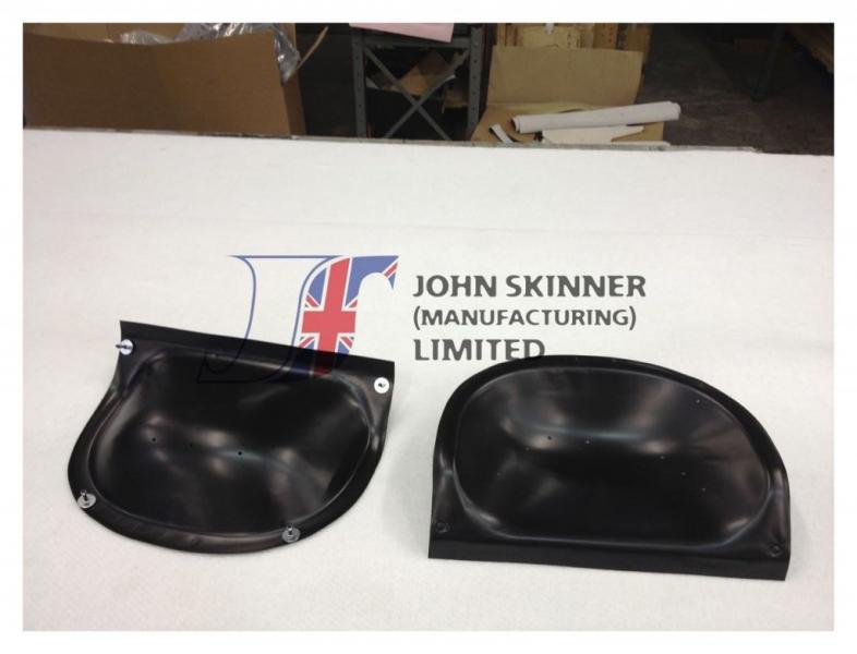

You could weld studs to your seats like the BJ8's came with. (See the Kilmartin Link and the Skinner Image Below)

NO!
Not unless you want to remove the new covers .
Then, install [FOUR] integral threaded fasteners in each pan
Now you can replace the new covers and secure the seats in place.

Yes, if you have already installed your new upholstery then perhaps you can peel back the material and use button heads or pan heads to secure them in place. I thought about using clips to hold them down, it's not like anyone is ever going to sit back there anyway. Even though the button heads produce a slight bulge under the leather, I thought it a better alternative to punching fresh holes through new upholstery.

No Velcro, but I did steal some of your ideas. I pealed back a bid of the seat cover and put screws thru with the heads strategically hidden under foam.
Worked perfectly, no budges or wrinkles. Looks really good.
