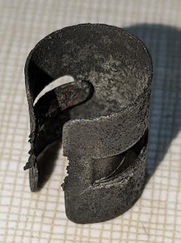

One of my rear fuel line clips is broken, and the part does not appear to be available from any of the suppliers. I can certainly use another type of clip that inserts into the hole, but then then locking feature will protrude inside the cabin. Does anyone know a good substitute part that will lay flat? Are there other solutions I should consider?

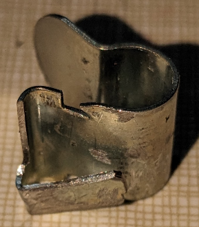

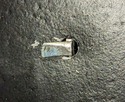

Thanks for mentioning the TR4 fuel line clip Steve! I happened to find one (Moss P/N 589-045) in a parts box and was able to quickly modify with a Dremel cutoff wheel so that it would slide into the hole. It worked out really well. The fuel line is held securely in place and protrudes very little into the cabin.
