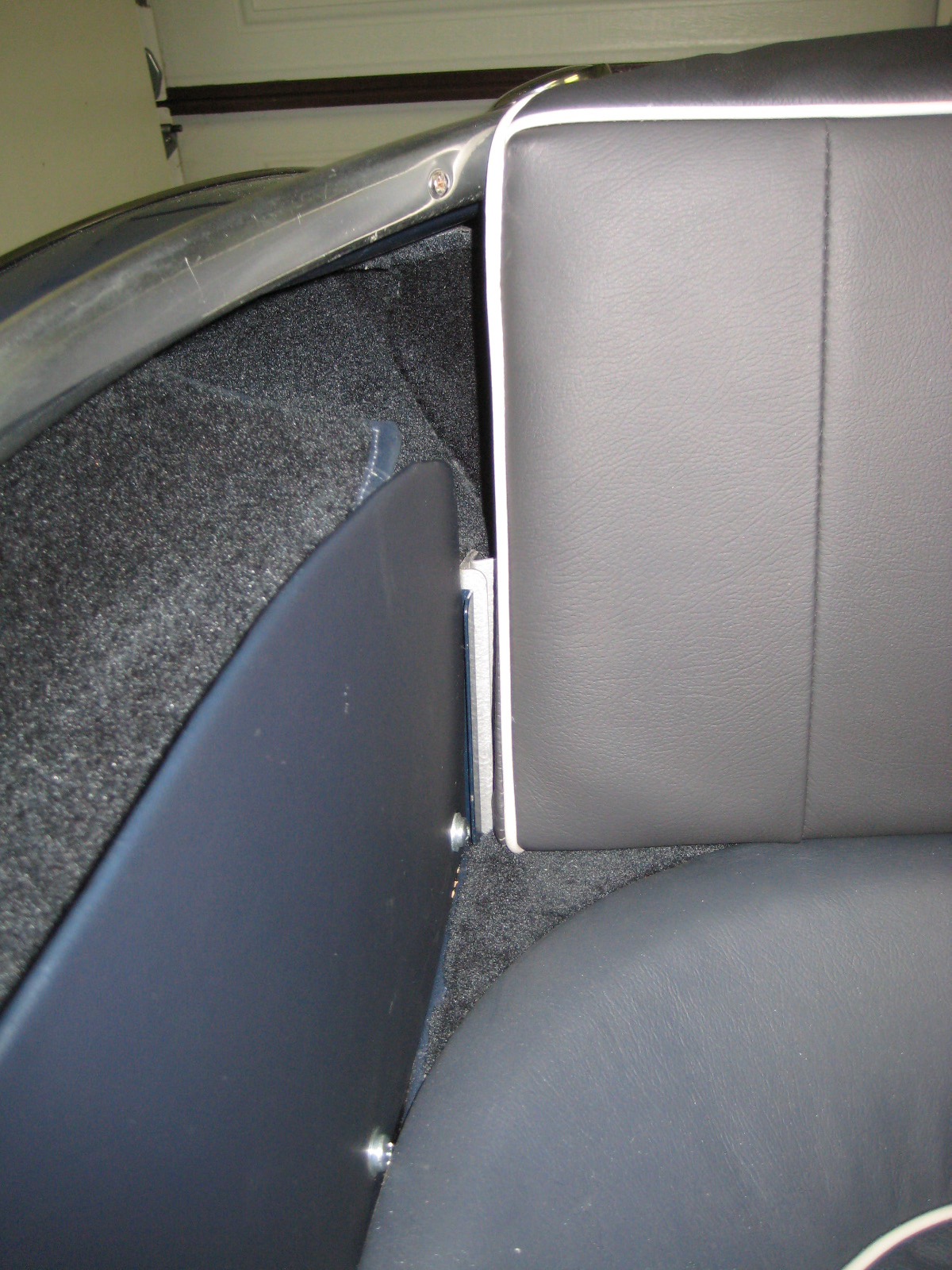

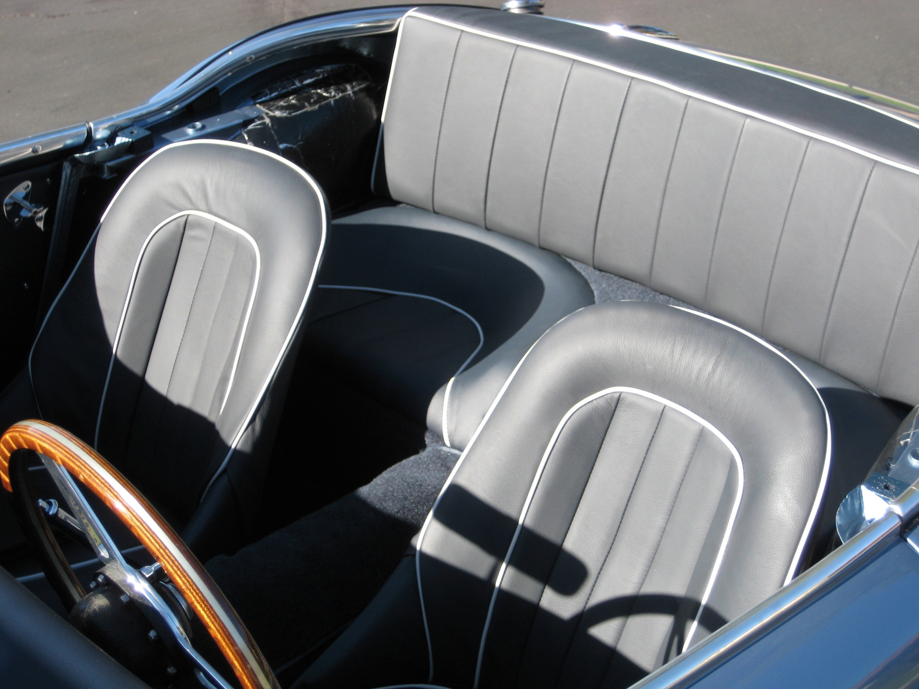

I‘m not an absolute purist so I welded the studs to the pans and went with the cleaner look. I much prefer it to the original look. The pans are original to the car so I had no issues with the install. Here are two photos that partially show the rear seats.
