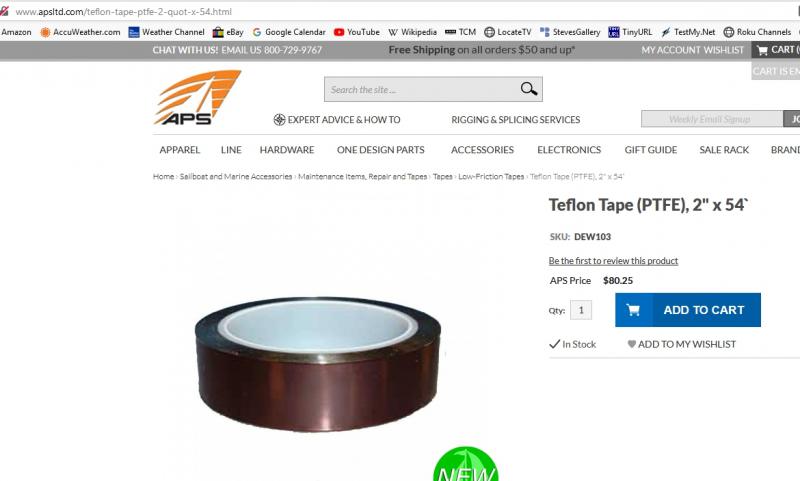

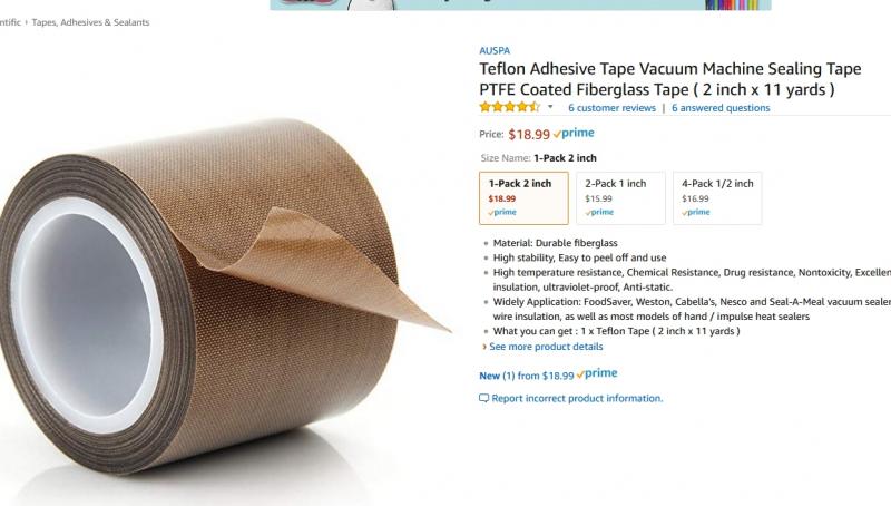

I've had this tape between my leaves since 2005 it works great! Never a squeak or groan:
One side is really slick; the other sticks well. Supplier is Annapolis Performance Sailing.
No idea why it's "New" - looks like the same stuff I bought then...

Yes, zinc is correct. The teflon tape or polypropylene works well too.
Provided it is specified for high pressure applications.'
Teflon as a material it's most notorious characteristic is cold flow.
It simply flows away from high pressure points.
Consequently in spite of its high dielectric strength it is used as wire insulation in only very highly controlled mechanical applications.
