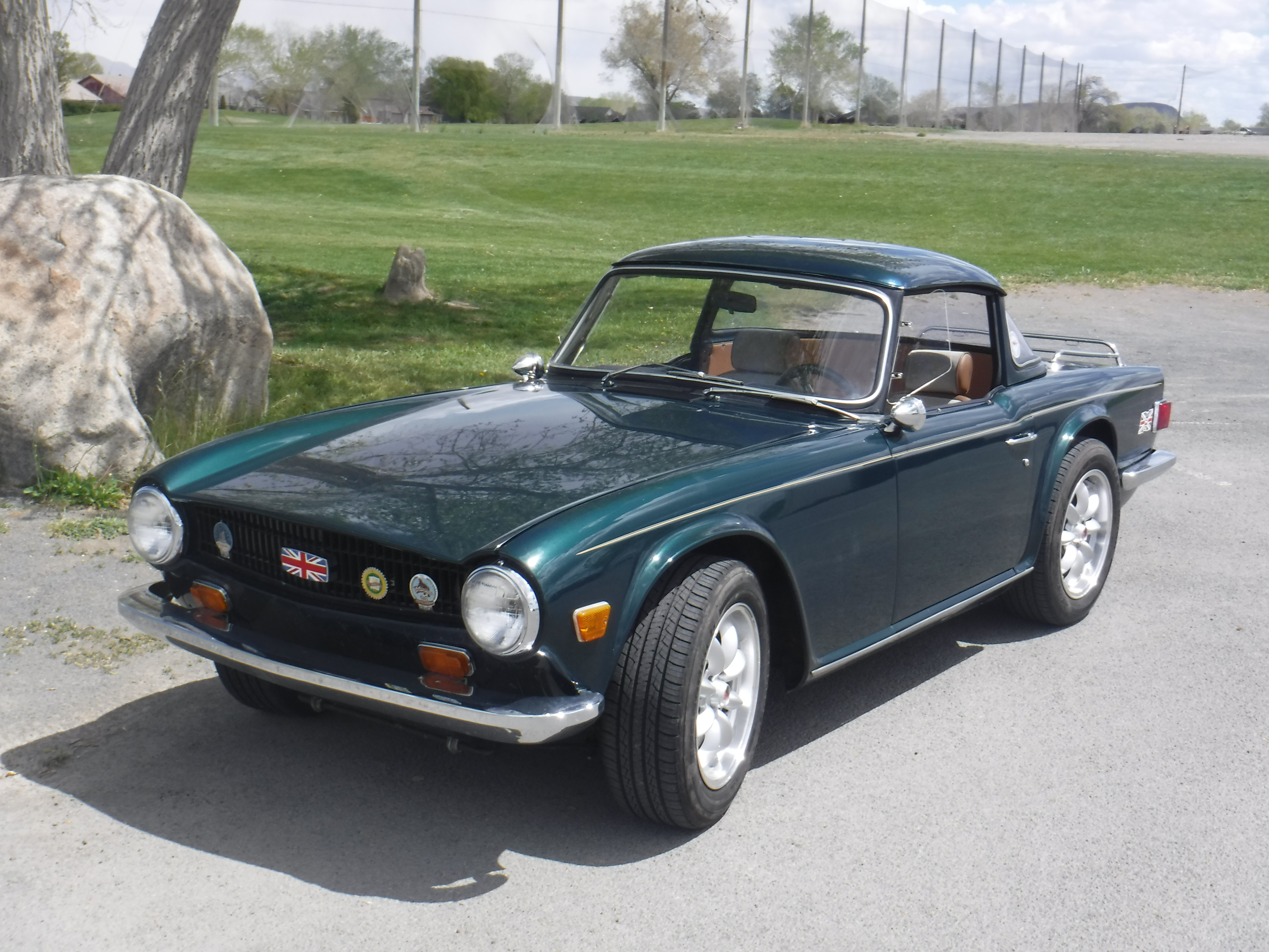

Summit racing. I needed them for the front of my TR 6 1973when I went to 16 inch rims. I got information that lug nuts should have 6 full threads. so I needed longer studs also. View attachment 70541
