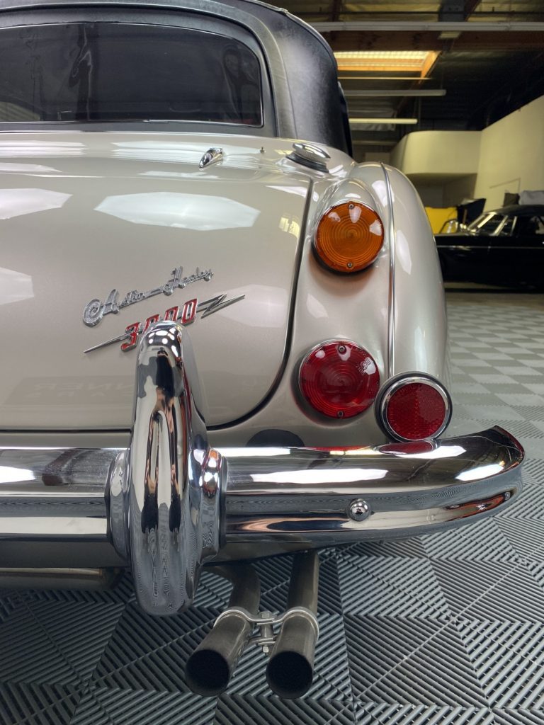

Also, when I view my tailpipes from straight down from the edge of my bumper, they are approximately 2 1/4" out/extended from bumper. Some observers think it is too far out and will cause point deductions during Concours judging. Does anyone have info on this? If they need shortening, the Guidelines are silent. What is the acceptable?

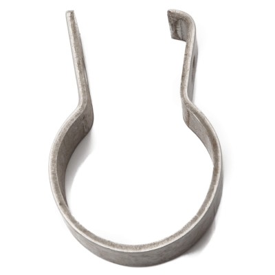

Related to the tail pipes, I've seen photos where there is a connection piece that attaches between the two pipes where they exit.
I don't see it in the Moss catalog, but I've seen it on some cars. Might look into that.
This photo is for a Kurt Tanner car.
(It appears to be 2 C-clamps, modified, bent end cut off? that are used in other areas on the system)

Thanks R. Calling Roger on Monday. I think the tail pipes end, on a angle, at the end of the bumper guards, which is approximately one inch from the actual bumper.

, I've seen photos where there is a connection piece that attaches between the two pipes where they exit.:
TH
That is a balance pipe that is most commonly used on V8-powered cars.
That pipe is usually installed right after the mufflers.

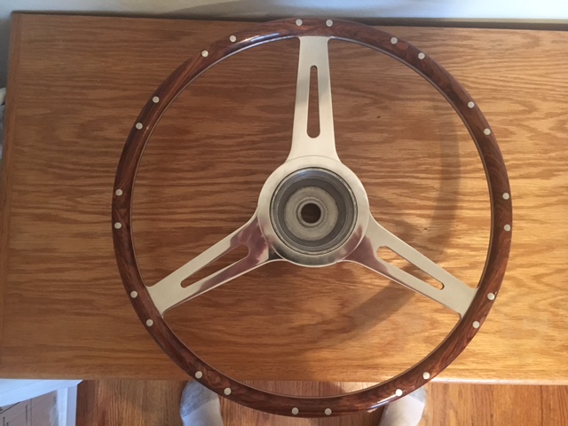

Here's the wheel Mike Lempert made for my 100M; IIRC it was made with rosewood. Note delivery took months, as Mike is usually backlogged and the wheel requires a modded hub (Mike mods a Mota Lita hub, which was also backordered).

Bob. That wheel is magnificent. Being a wood artist myself, I can appreciate the beauty of you wheel. Luckily, I have my hub and all other parts in good working order. Just need the wheel. Molta said they can not make one until "sometime next year"! Wondering, could they be so busy?? Crazy.
