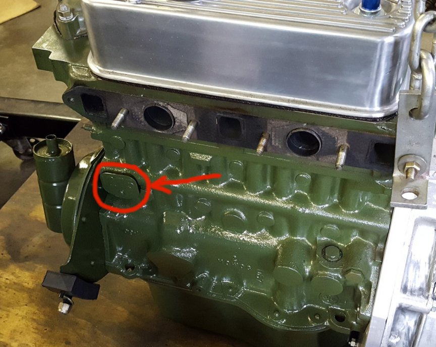

Bronze
And don't many 1275s have a plaque-thing that says "1275" on them?
drooartz
drooartz
If it's still there. I don't think the one in my Morris still has it. Good to look for, though.
