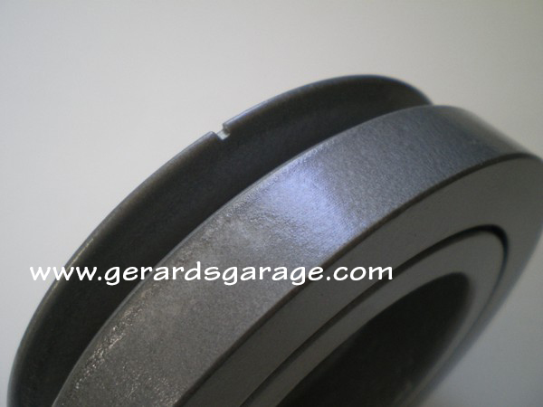

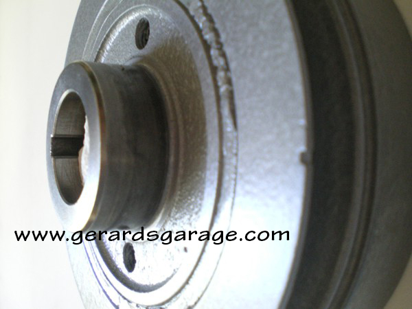

Here are some photos of the factory mark and it's location in relation the the keyway. Notice the the mark is directly opposite the keyway. Rotating the engine to TDC should put the mark in the area of the pointer at the bottom of the timing cover. If the rubber ring has deteriorated to the point that the out ring has rotated away from the inner hub, these will no longer be in line and therefore give you incorrect an timing reference. That would be the time to replace/rebuild the damper as it will be rubbish.

Q: I can't go out and look at ours, but can you see that wee dint in the pulley, so far from where my eyes and strobe light would be?
And thanks for the photos Gerard - I now know what to look for when the car comes back (and when the snow and the salt are gone...) Doug
