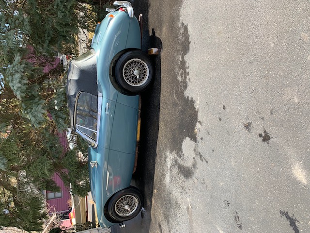

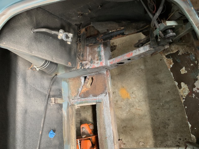

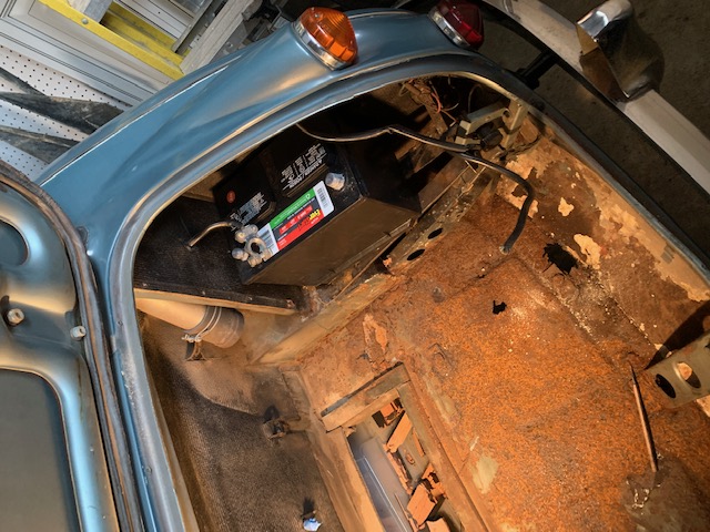

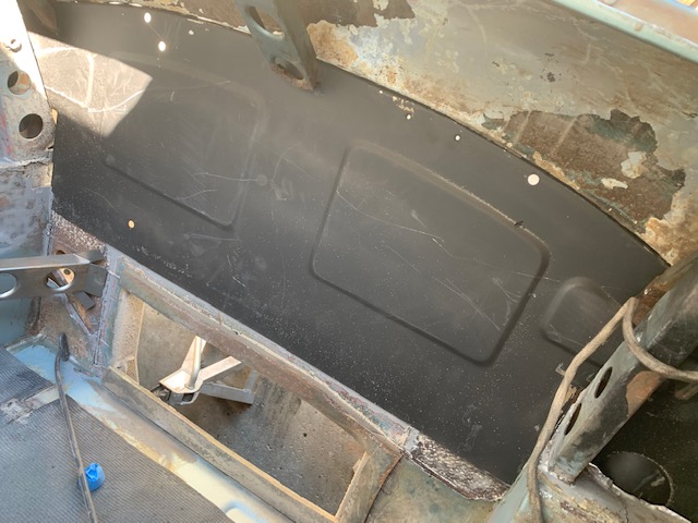

AN6-TX
Great progress! Keep the pictures coming...
