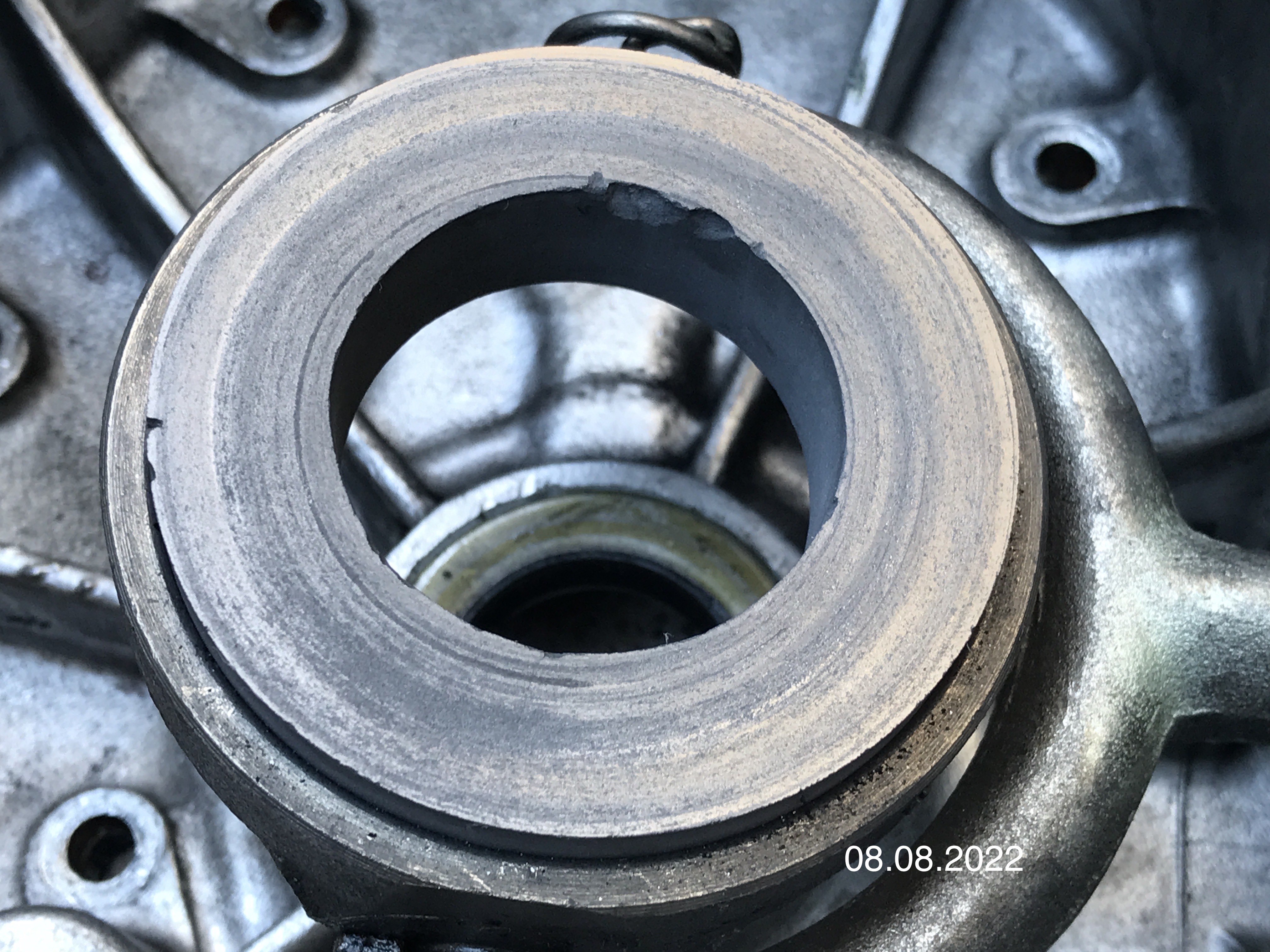

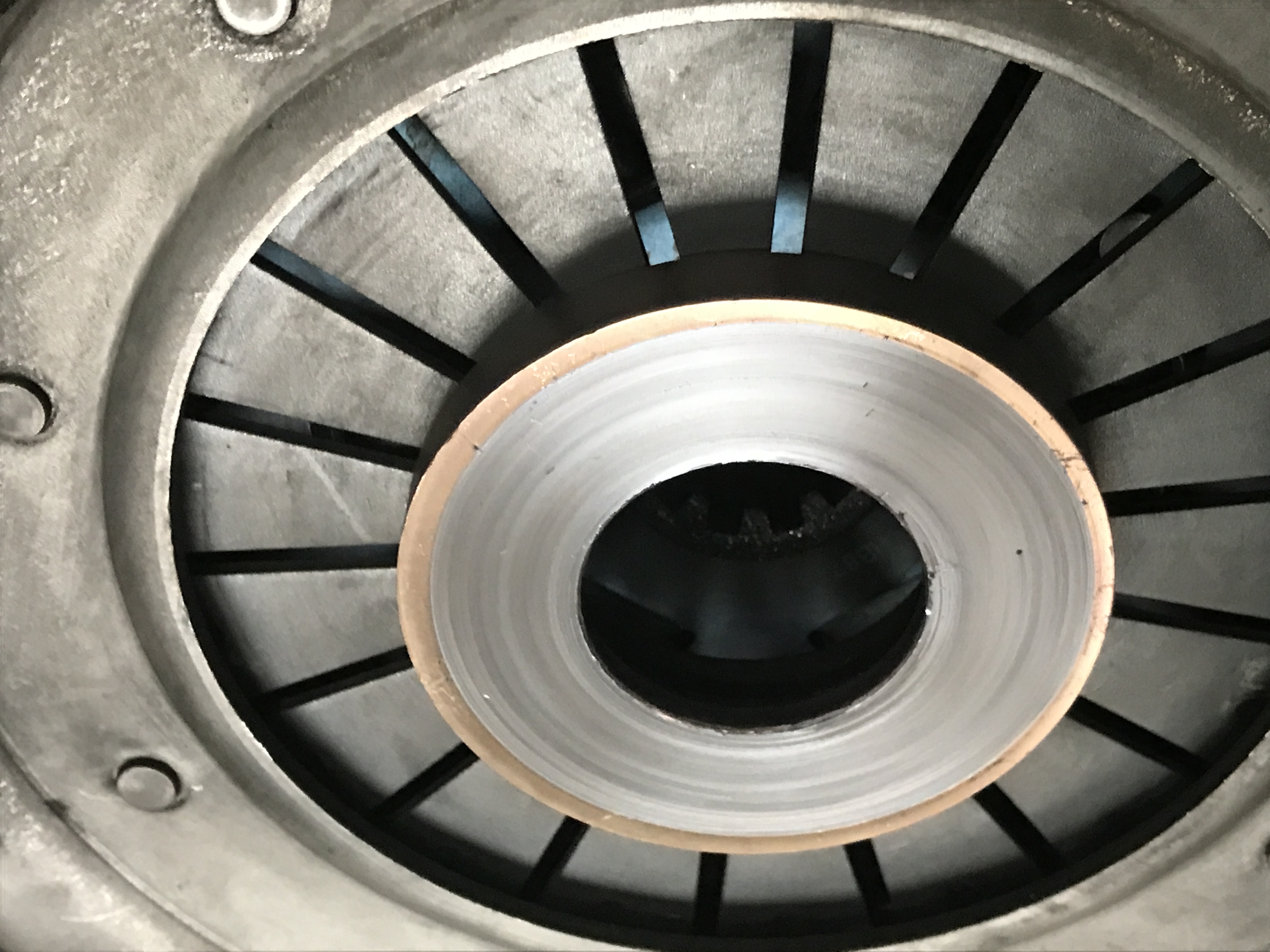

I have the DW unit. 500 miles on it now. Why is the release bearing wobbling? See attached YouTube video.
I believe the wobbling is causing vibration to the throwout bearing - notice the wear pattern on both bearings are not centered. That vibration may be traveling to the clutch housing fork, possibly while I feel vibration in the clutch pedal?
I'm currently trying to track down a tapping noise I'm hearing in the bell housing; wonder if it's related. The throwout bearing fork has a little play, but not sure if it's enough to make a tapping sound. The bell housing can amplify any sound, so there's that.
Why is it wobbling? It shouldn't, right?

Should it wobble? No. Why is it wobbling? It's not centered. Is it the source of the ticking sound? Quite possibly.
I thought my release bearing fork had too much vertical play and replaced its bushes (my dad, rather sarcastically, said "It's only got about 50,000 miles left on it"). There was no vibration or any other symptom either before or after the new bushes (a bigger job than it should have been).
