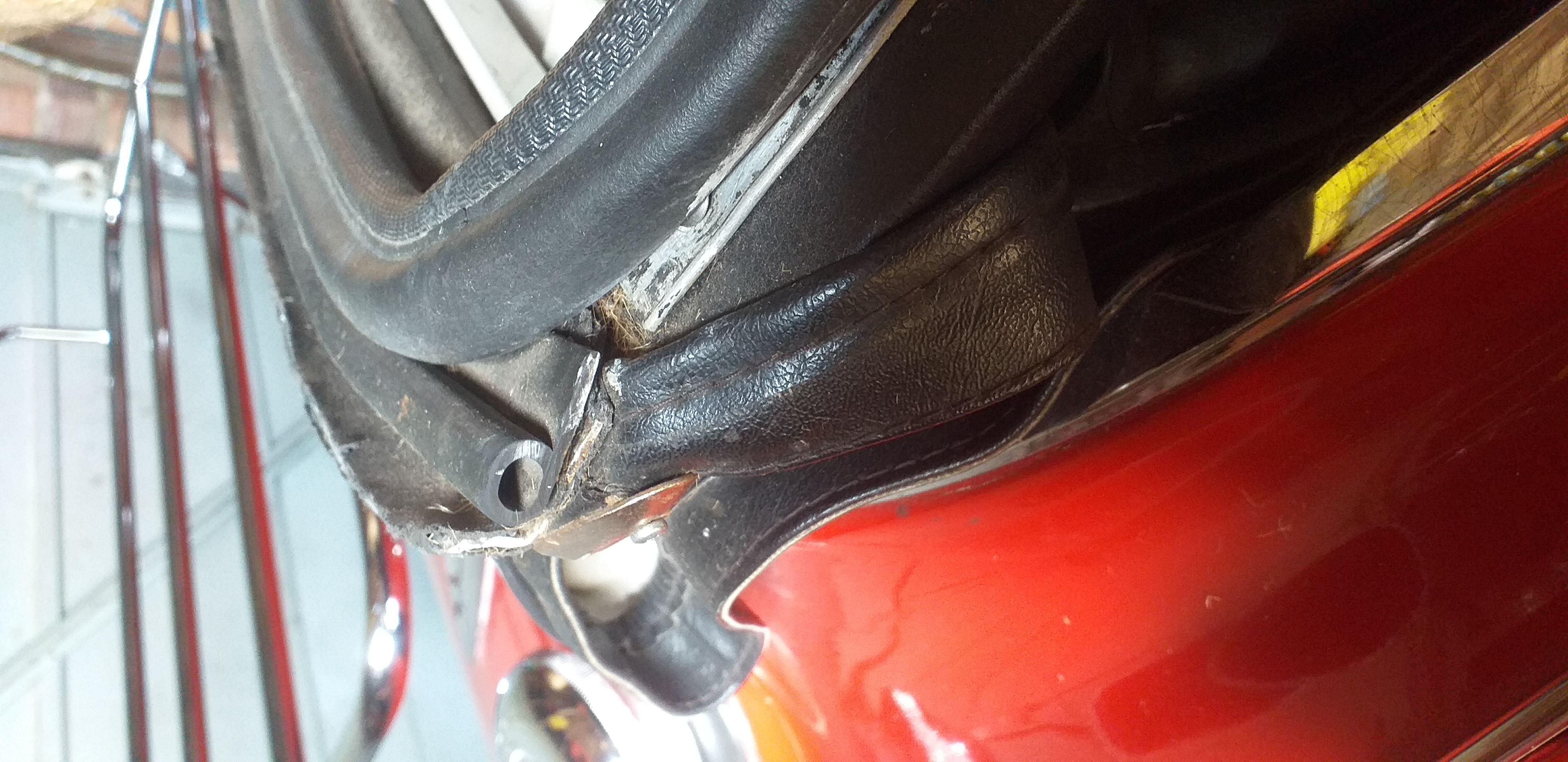

Afternoon Gents,
Has anyone any close-up pics of the front bow/aluminium plate and seal on a BJ8 hood?
Just recovering all my woodwork and want to get this correct.
Any help appreciated as always !
Many thanks
Alan
Healey Nut
The wood gets covered with fabric . Aluminum extrusion piece gets screwed to the wood .seal fits to the aluminum . Don’t forget to staple the grey straps to the wood before you put the top on or you will be taking the top off again to do it .
bob hughes
Is this what you are after ?
Hood bow, aluminium rubber relationship.jpgHood bow, aluminium rubber relationship.jpg
