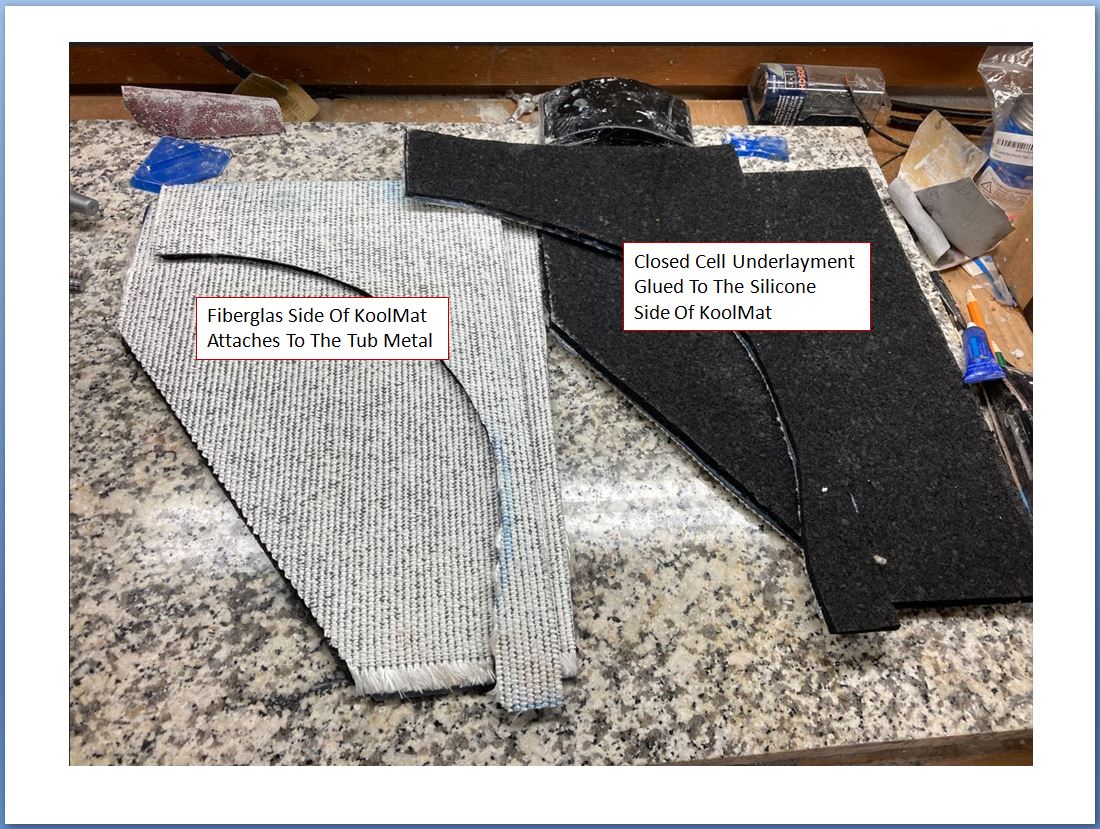

Not sure how far along you are, but I used a 1/4-inch thick closed cell foam (will not absorb water) instead of jute. The foam is designed as an underlayment for marine carpet and it holds up well in hot environments.

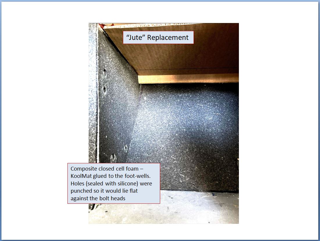

Since I had lined the tub with KoolMat, I had to glue the foam to the KoolMat using silicone adhesive; and it worked very well. Unfortunately, I had to remove the KoolMat installed on the vertical panels initially, and then install the improved composite foam-KoolMat pieces. :( This was because it was better to glue the foam to the KoolMat when it was laying horizontally with weights, and letting it cure for 24 hours. You understand the drill: move ahead one step and then move back two steps after we learn how to do it.

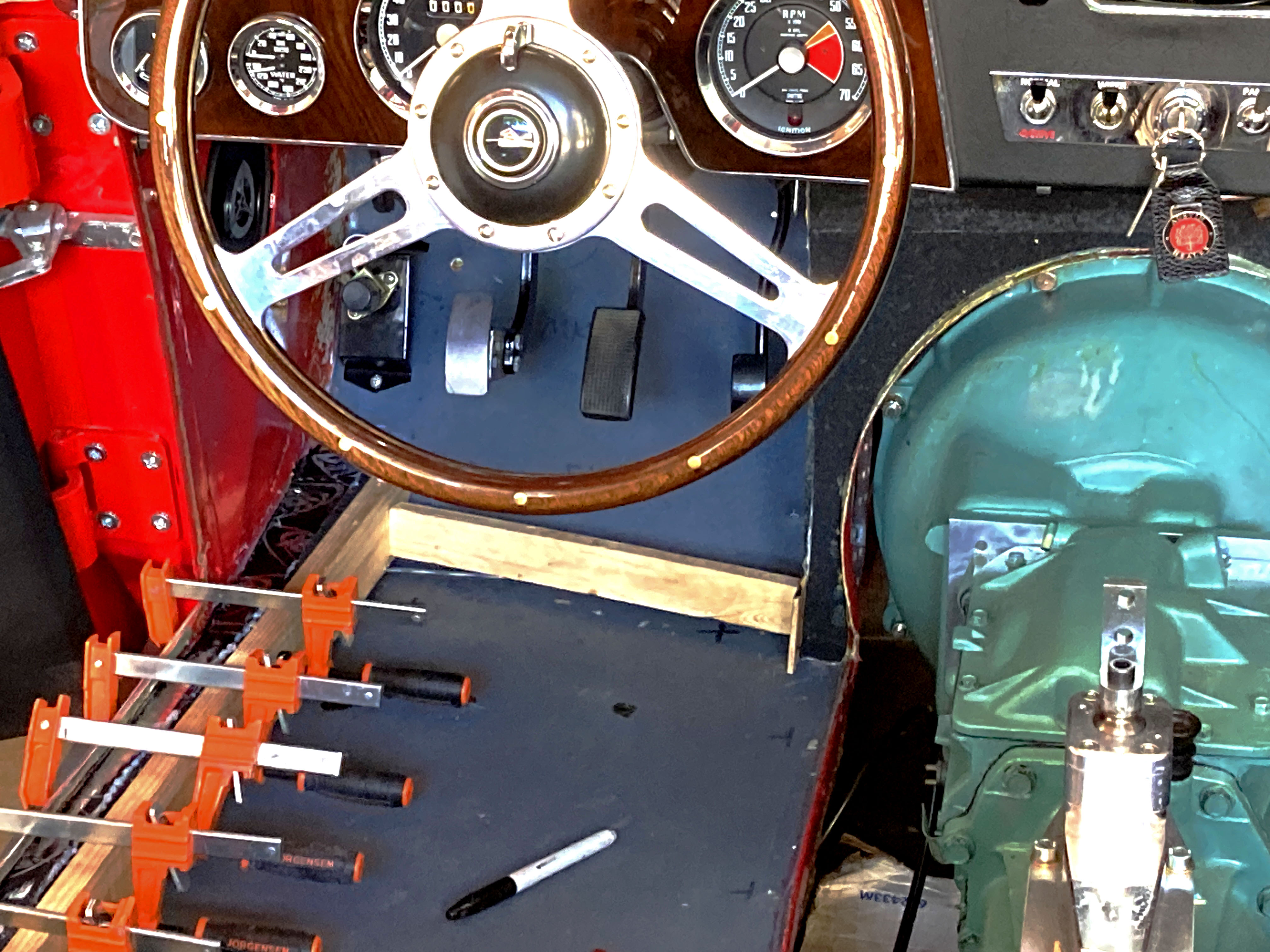

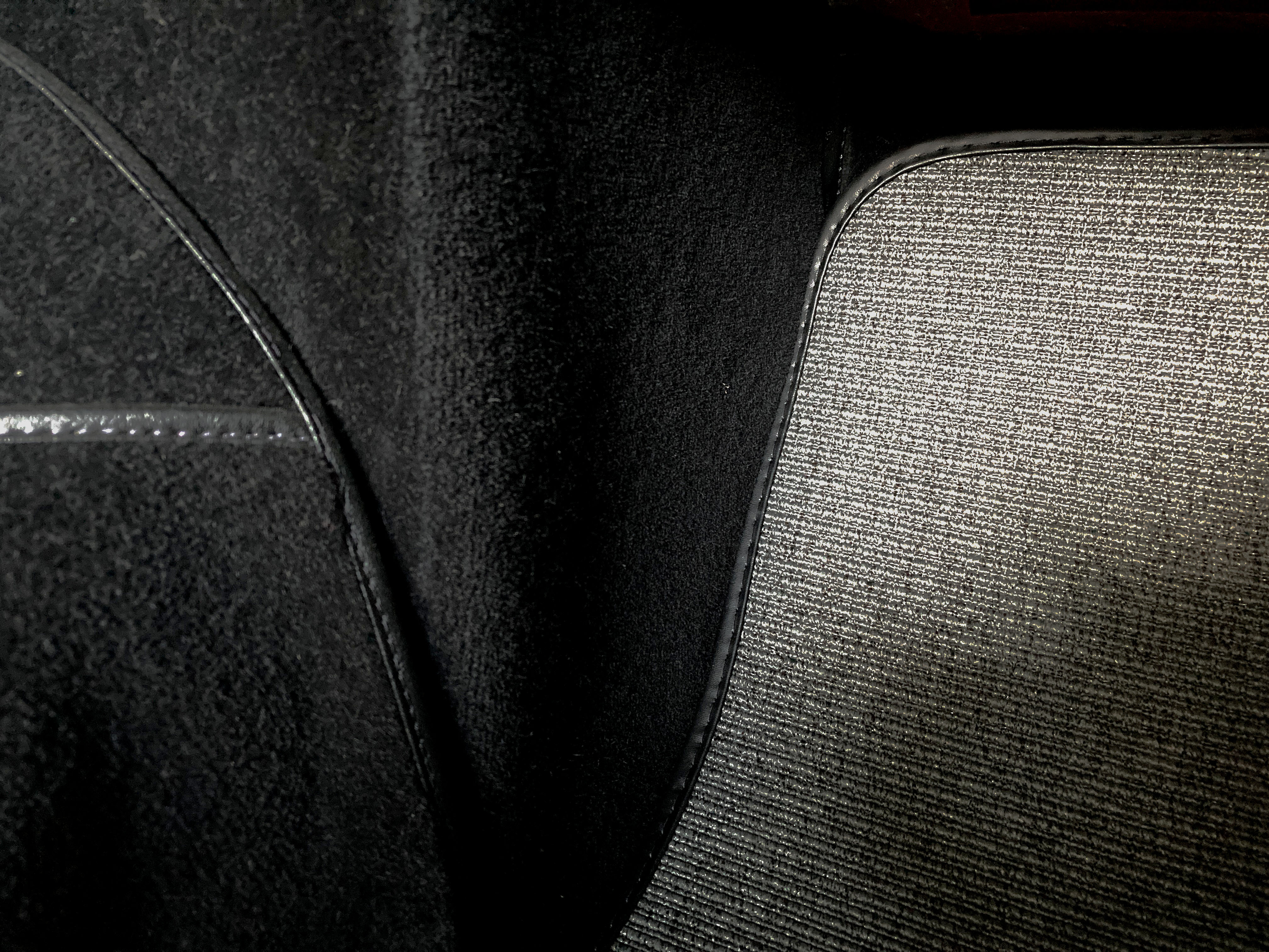

The first picture shows the composite foam-KoolMat pieces and the second shows them installed in the foot-well area. The third and fourth pictures show the KoolMat installed with the composite pieces on the tunnel area and all edges sealed. The foam is glued to the vertical panels and is loose on the horizontal panels, as was the original jute.
The upper cardboard seen in the second picture is a form I used to make a fiberglass cover that screws to the upper panel to seal it.
The last picture shows the finished foot-well area and the carpet folded under the transmission tunnel as described in the video (really difficult to photograph black carpet in a car in a garage). The lighter gray area is a Cocomat used to protect the new carpet. They send you paper patterns to customize for an exact fit. Its a 1960s sportscar. It has to have Cocomats!
