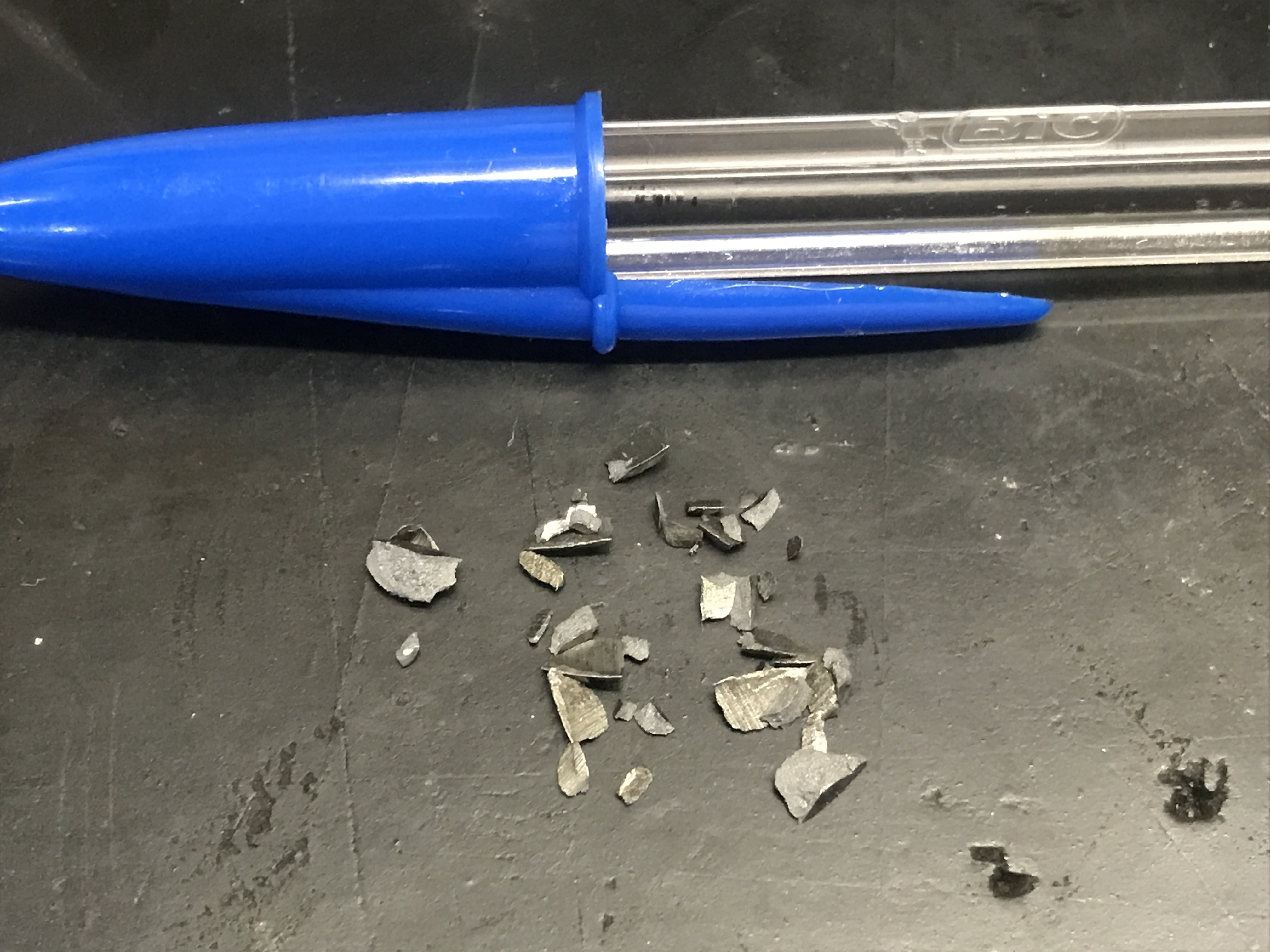

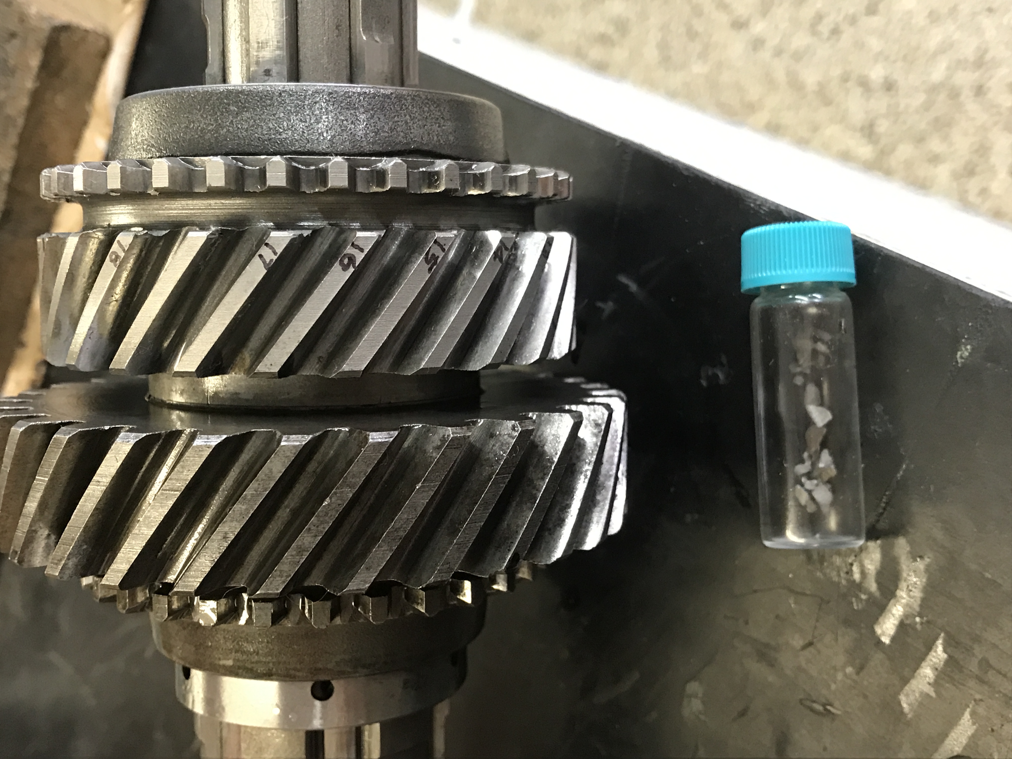

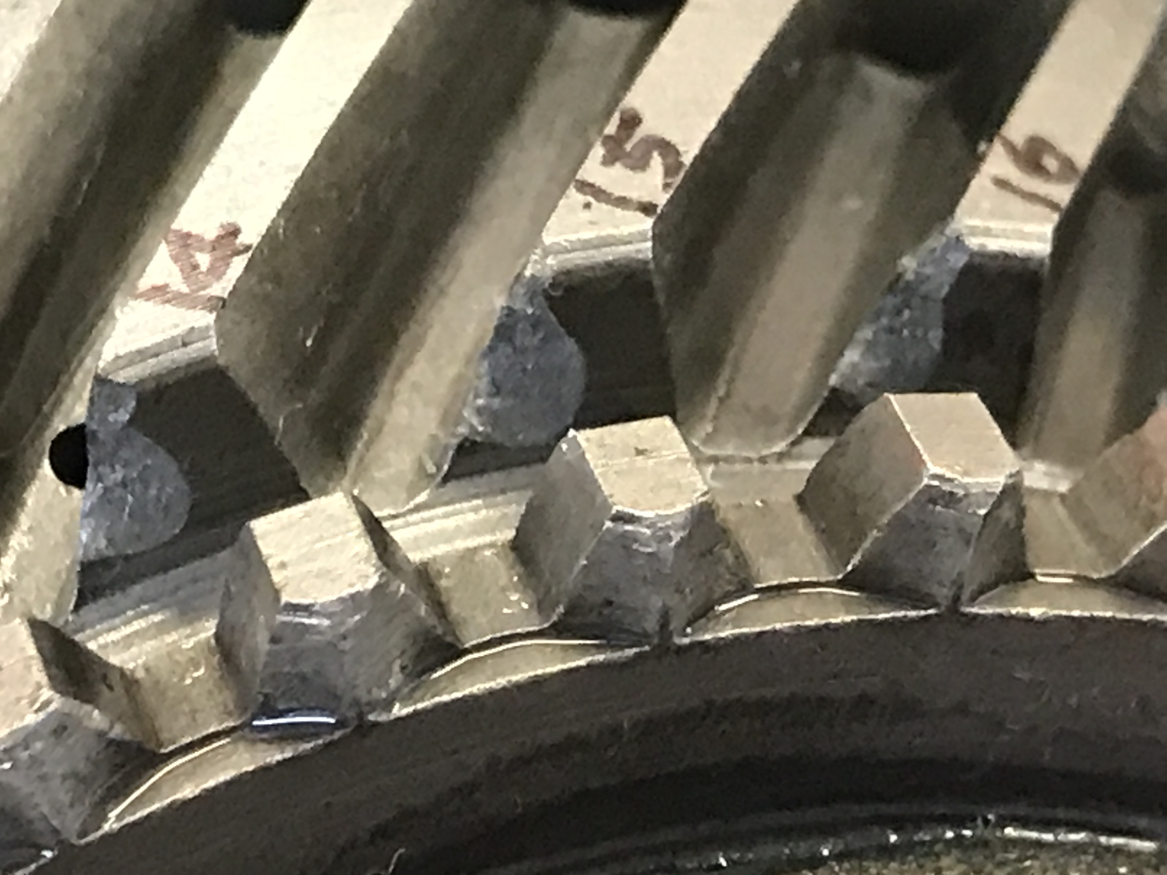

So I installed the DW 3/4 hub assembly (no pins), gears are loud, drain oil, see metal chips. On the bench I find 18 chips on the left edge of 3rd gear, from a 10 minute ride. (It didn’t have any damage previously) It seems when the hub slides the right, it over extends and hits the edge of the teeth, then springs back to the place it should be. I have new selector shaft springs, ball bearings, new DW selector shafts. Did the gear chip because it doesn’t have the locking pins? Why did this happen?

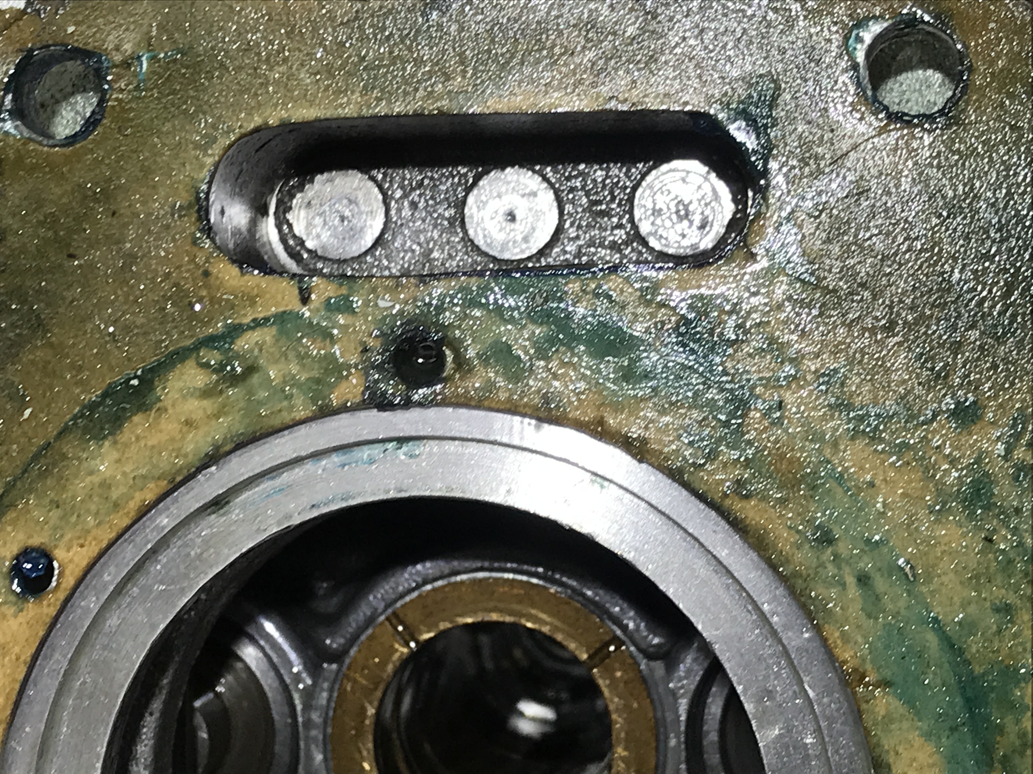

The clutch housing has a buffer pad. That address the shaft going too far forward. The OD does have an area like the clutch housing for travel of the selector shafts. Should that also have a buffer pad?
Here’s photos of the 3rd gear damage. Do I need to replace 3rd gear or can I still use it? I will be going back to my 3rd hub with the locking pins.
