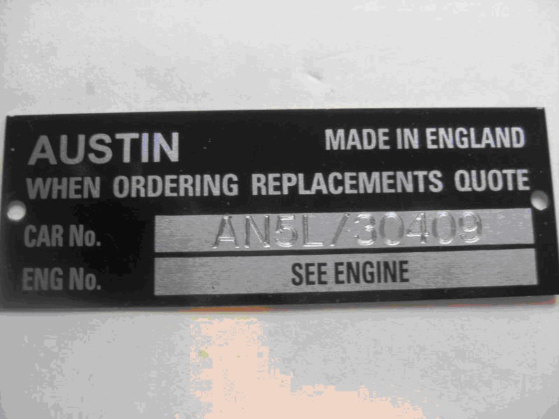

What is the proper tool to put AN5L / 26655 on my new plate?
These - https://www.harborfreight.com/36-piece-18-steel-letternumber-stamping-set-60670.html

VIN plateb.jpgI had a trophy shop engrave my old BE, but originally it was stamped at the factory. As you can see, my letter size was larger than the original. The HF says 1/8" .....measure your existing one and see if that works.

Clarke Spares will stamp it for you with the correct dies in the current size. Googke Ckarke Spares. They will also do door plates for VIN and body number.
I'd take a shot at restoring the original. Nothing to lose.

View attachment 34046I had a trophy shop engrave my old BE, but originally it was stamped at the factory. As you can see, my letter size was larger than the original. The HF says 1/8" .....measure your existing one and see if that works.

I did a little more searching and measuring. Looks like the original is closer to 5/32". Trophy shop sounds like a good idea.

Yes was going to say originals were stamped from back.
macsprite
Harbour freight tools has stamp sets that are the correct size. I stamped a new plate for my recent bugeye restore and it looked "original".

I'm with Jim....Clarke Spares did a prefect job on my VIN and engine plates.

I would much rather restore the original. Spray it with black paint. The lettering is raised and you can polish it by rubbing it face down on 1200 grit sand paper until the border and lettering is clean and bright. The new plates are just screen printed and flat.
