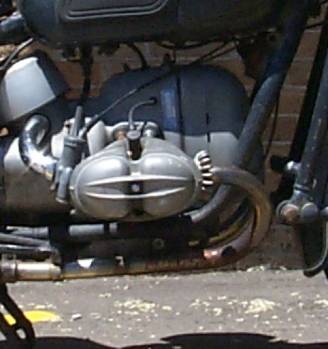

I replaced the motor in my '65 BMW cycle in 1975 or 6. CA cycle titles carry both the frame no. and the motor no. The replacement motor was a brand new "replacement part" factory motor -- which came unnumbered. So I went to the DMV since the old number on my title no longer applied and they gave me an "assigned number." The number (DMV54106CA) was on a metallic self-adhesive sticker, which they stuck on my motor. Then they hit one end with a little DMV logo stamp for extra officialness, I guess. Future registration cards carried that motor number.
You can make out -- though not read -- the sticker in this photo. It's the blueish thing on the side of the motor.
