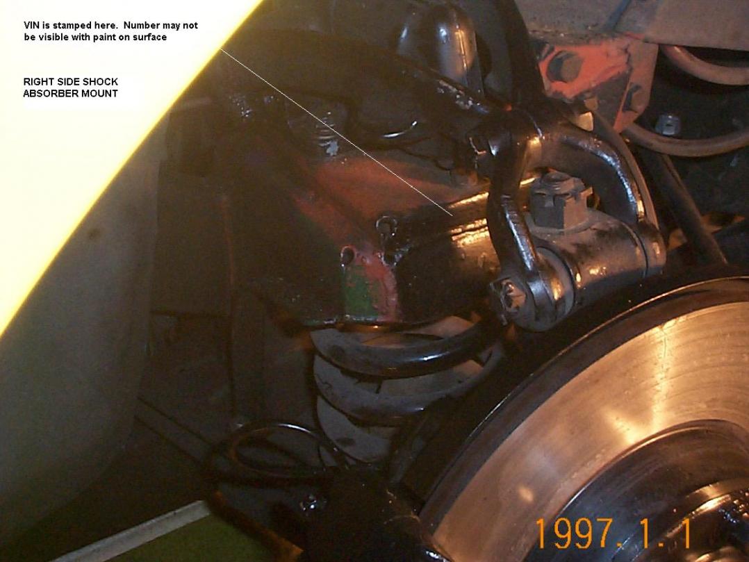

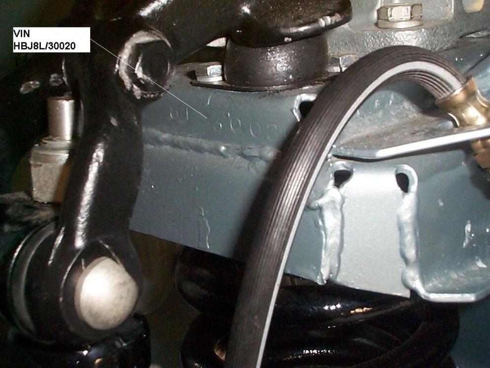

If this works, then you should see some photo examples of the VIN stamped into the right front shock absorber mounting tower for BJ8s. As far as I know, the VIN isn't stamped here on other models.

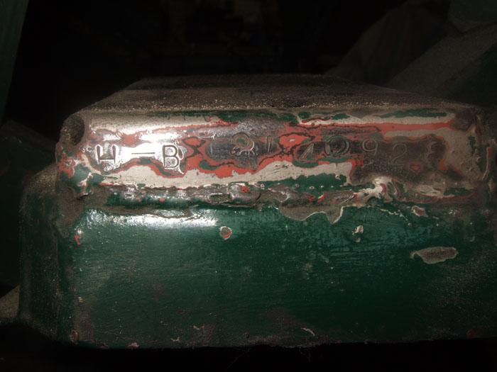

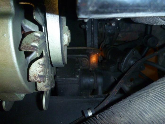

There is another number on the shock tower, visible looking down on the front surface of the shock tower from the engine bay. The photo should illustrate where the number is (the bright spot). This number is on other models as well as the BJ8, but it cannot be used to determine the original VIN of the car. John Thompson Motor Pressing manufactured the frames and sent them to Jensen Motors for construction of the chassis. I do not know whether John Thompson or Jensen stamped the number here. It was significant to their production, but no cross-reference exists, so far as I know, to allow the number to be used to identify the VIN.
