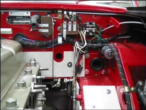

Here are some firewall photos I found. Note the position of the VIN tag below the body tag on the BN6 versus offset on the 3000 BJ8. That location was the same for all 3000 Slide122.jpgSlide115.JPGSlide103.jpg's

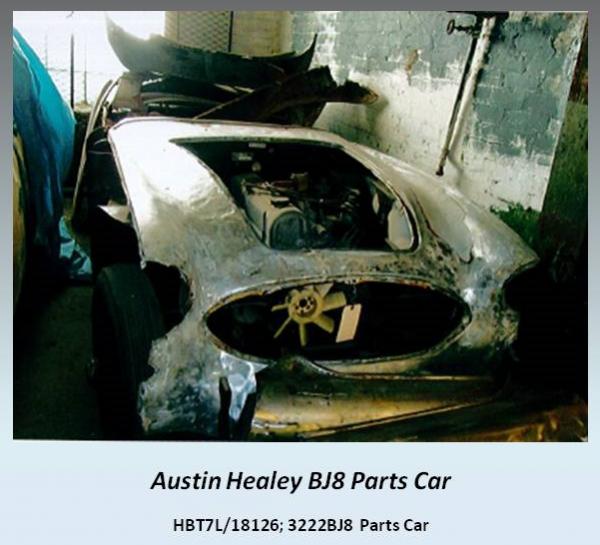

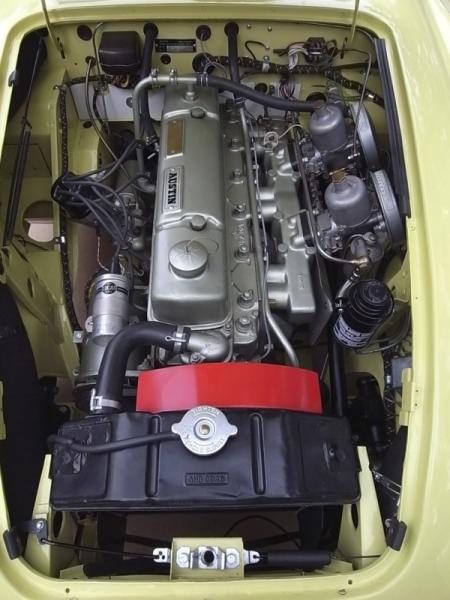

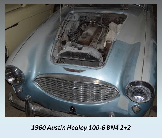

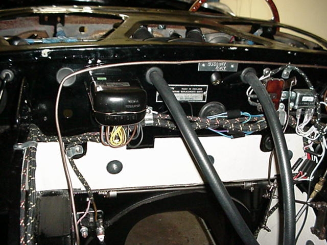

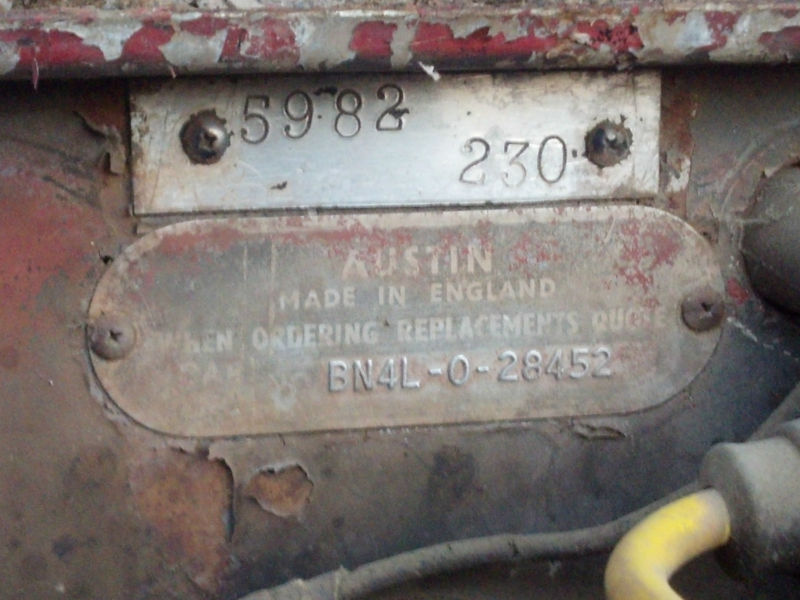

I have a BN6 100-6. The square VIN Tags on the BN6's are offset just like on the BN7's. The rounded edge BN4 VIN tags are centered on the firewall. See images below. (Black BN7, Yellow BN6, Red BN4, Original BN4, Works)
That being said, I'm sure the that some of the tags were put in different places as well, (See last Image) but most of the VIN tags were installed as described.
