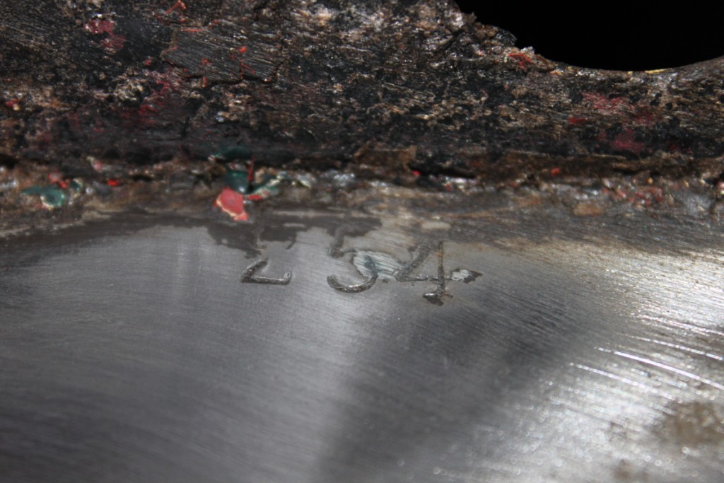

254.jpg I found the attached number stamped on the bulkhead of my very early Sprite where the wiring passes through on the right side of the car no other number as all have been removed (including engine dash etc.) But Heritage information do not recognise Sprites below #501 so what happened to the first 500? Can anyone help? Regards Robby

The first car was number 501. The bulkhead number is not a VIN number. It was some sort of manufacturing control number and was not tracked on build sheets.

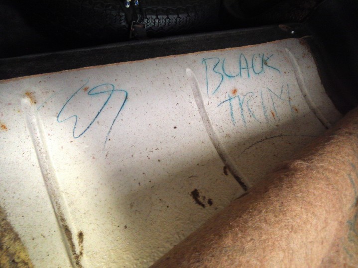

One more place to look for the chassis number on a bugeye (which is the VIN #) besides the chassis plate on the frame rail under the carbs and in writing in grease pencil on the rear of the dash is in writing in grease pencil on the horizontal surface behind the seats under the hardura. It was there on my car before I had it dipped. (it was also on the back of the dash on my car as well) I've talked to other BE owners who've found it there, too.

Rick, according to the Terry Horler book on Sprite originality, the number in crayon on the bulkhead behind the seats is the body number, written without the BAE prefix, not the VIN. Are you sure it was the VIN that was written there on your car? I believe the only place the VIN was written in crayon was the dash.
I could be mistaken and since the number is no longer there I'll have to yield to Horler. Wonder if anyone has an original marking still intact? Too bad there's no video of the bugeye assembly line video for us to watch how the cars were put together
I recently took these of my friend's Bugeye. You can see the first digit of the chassis number in the upper right hand portion of the last pic. 37070. Other writing R/C (rev counter) W/W (white walls) MPH (MPH speedo) 5L (upside down on radio cutout), on prop tunnel and jumpseat. Also BLACK TRIM on jumpseat. Also appears to be someones initials.
