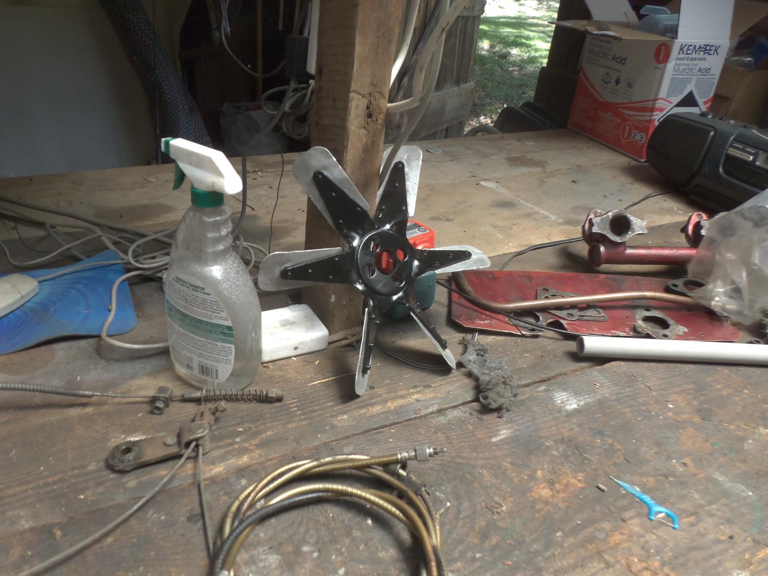

Could someone please post an image of the TR3 Tropic Fan.
I've heard about this thing for years but don't think I've seen one.

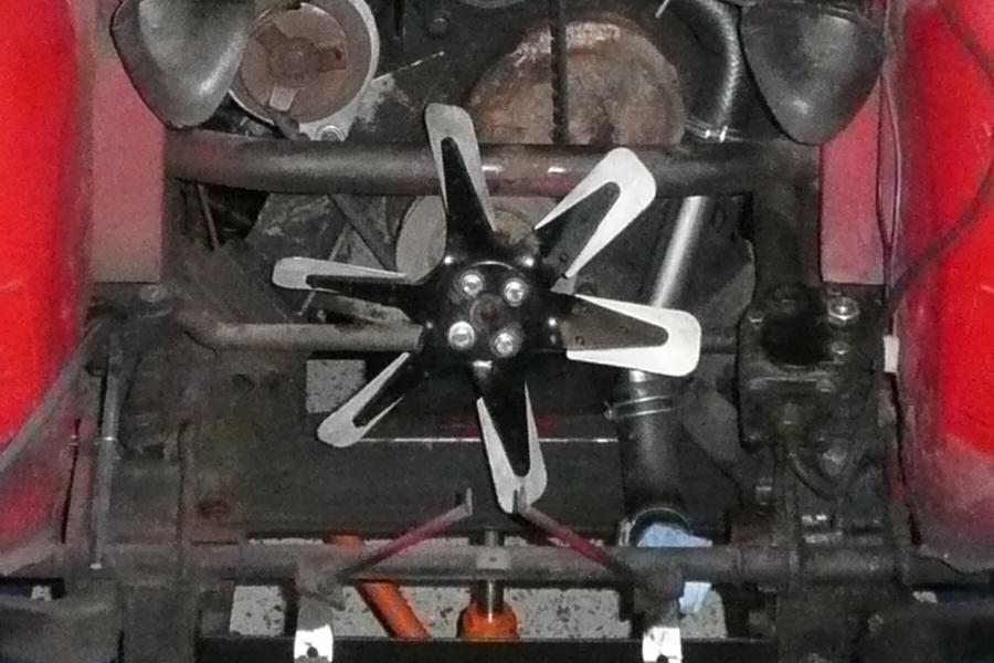

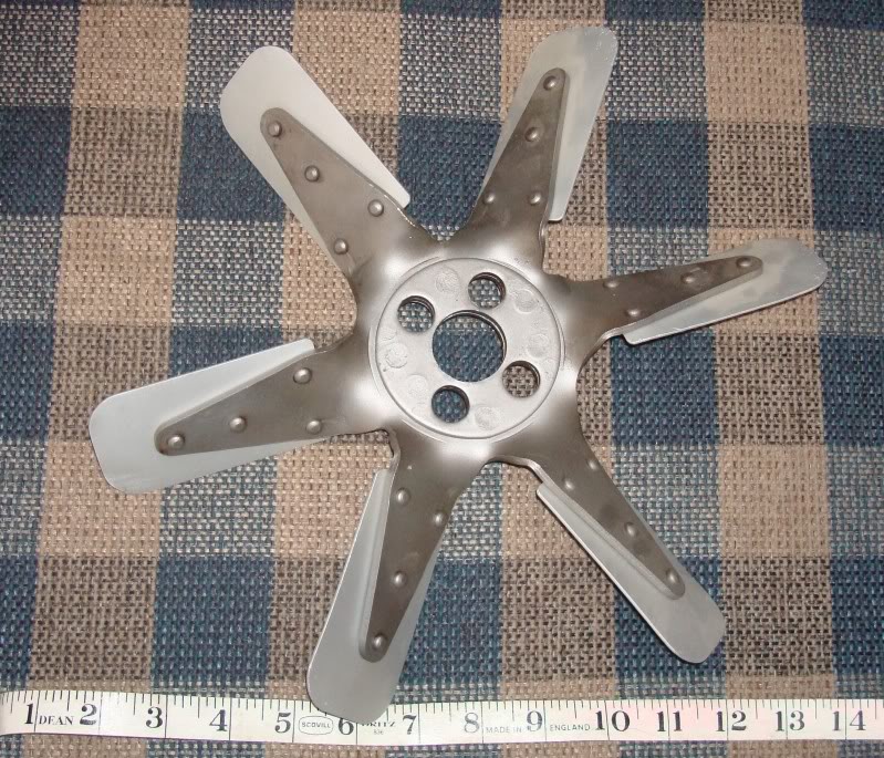

This is what I believe to be a tropical fan, compared to a standard one.
Jesus

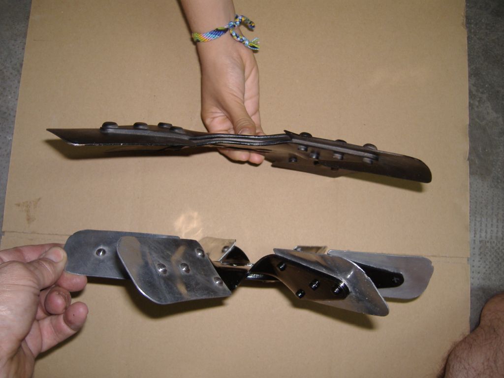

Yet another view:
As I recall some had larger rivets than others though I know of no problem with either.
Cooling advantages aside -- the tropical also has less aluminum sticking out beyond the cruciform. I think (hope) that design is less prone to fatigue and breakage.

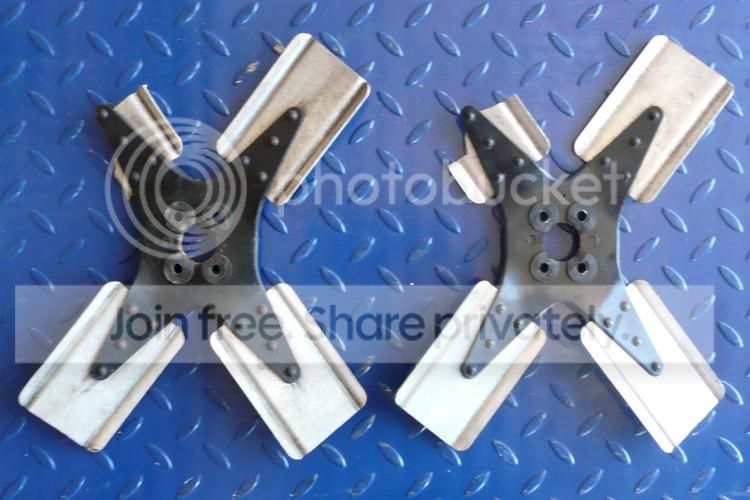

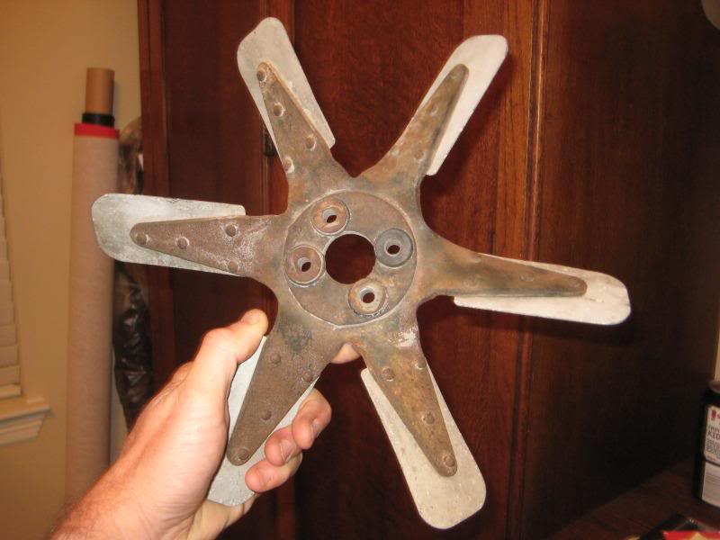

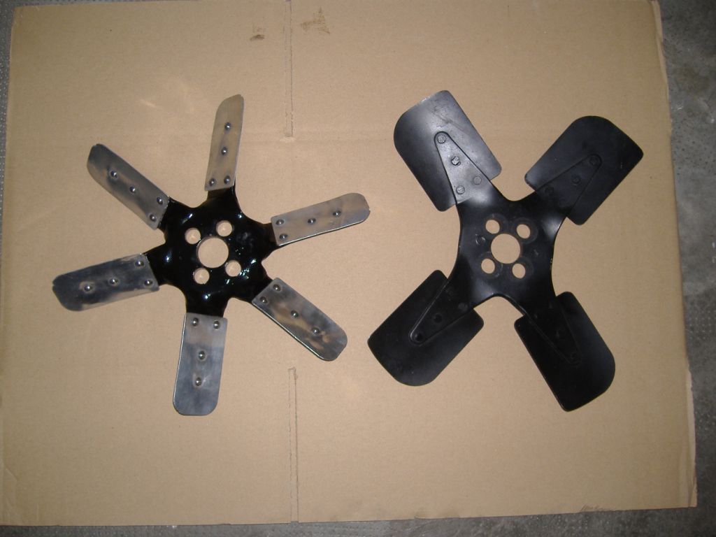

Here is mine 100_0844.jpgas well as a couple of pictures of others I have collected over the years100_0844.jpg.TropicalFan.jpgtropical-1.jpgTropical_zps3dccced8.jpg

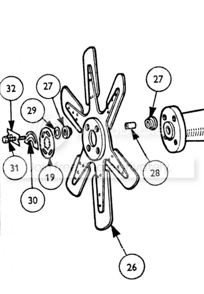

Here's the drawing from the manual

The 4 blade fan has always been inadequate in warmer climates than the UK. I recently gave a friend a spare (ex Triumph 2000 sedan) tropical fan as per pic 4 above. His TR3A now runs at normal temperature in our very hot TX like summers.
