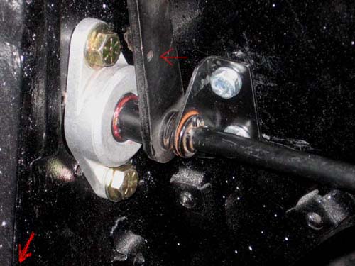

On my TR3A the return spring is mounted on the right hand side of the car. One end is connected to the arm on the throttle cross shaft that runs across the top of the bell housing from left to right. The other end is attached to a small metal tab (much like a hook) on the bulkhead over the bell housing.
martx-5
Here's a pic. The top arrow shows the hole where the spring goes in the fulcrum. The bottom arrow shows the approximate location of the tab that the other end of where the spring goes. It's a little further down and right near the edge.

Thanks for all of your help everyone. Incredibly fast and helpful comments. I located the tab. It had been pounded down sometime in 1959 when they prepared the car for racing. A bit of hammering with a sdrewdriver and it was as good as new.. New spring works great- Maybe I can finally get it to idle properly.

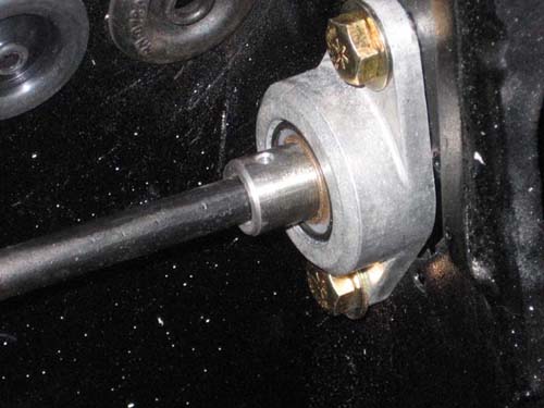

That is a really nice looking throttle shaft bushing. Is it a custom fabrication or available off the shelf?
martx-5

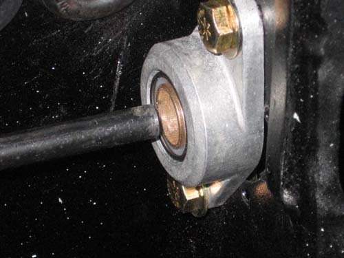

Those are self aligning bushings that I got from McMaster. The one on the other side has a different diameter bronze bush (larger) so I could accommodate the adjoining piece (the piece that pins the pedal to the shaft) without the step in it. It makes disassembly in the car with the engine in place a much easier project if I ever have to replace the McMaster pieces.
Edit: Here's a couple of pics of the other side...
