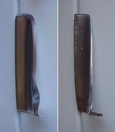

Possibly not just an issue with Moss. The ones I got from Vicky Brit about 12 years ago fit fine. The ones I got from TRF about 4 years ago were okay for the big pieces but the smaller pieces were strangly shaped and would have required considerable massaging. TRF on left, VB on right.
In the end I kept my old ones except for replacing the one large one that had taken a bad dent.
Keith, the good news may be that I have not encountered a fitment issue with the big piece, just the small one -- and you say you already have those in hand.

sp53 I agree with you 100% about the quality of the guards. None of the four pieces I have will work without removing at least 1/4-1/2 inch from the edge that should almost lay flat against the fender or body. One of the large pieces can't be used because there is not enough material to fold it over the edge of the fender on the outside. I would have to screw it to the fender on the outside edge. Geo the small piecse pictured look just like yours. The only good news I have is that that they came with the car, and cost nothing. The guards selling on ebay are $300.00 (ouch).

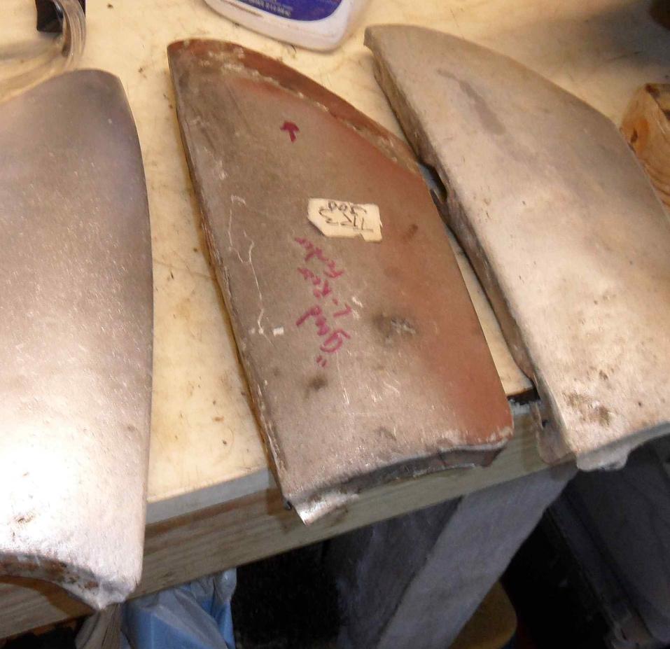

They are soft, and though I have only purchased used ones off ebay, and had some that came on fenders I purchased, there is a big difference between some of them. The newer shiney looking set were set aside after I found how easily an original can be cleaned. These two pictures are of the same stone guard (the one in the center of the bench is on the car). A little steel wool, hammer for small dings, some mothers, and it looks better than the shiney ones I started with -and the difference in fit is noticable. dirty_guard.jpgSame_cleaned.jpg

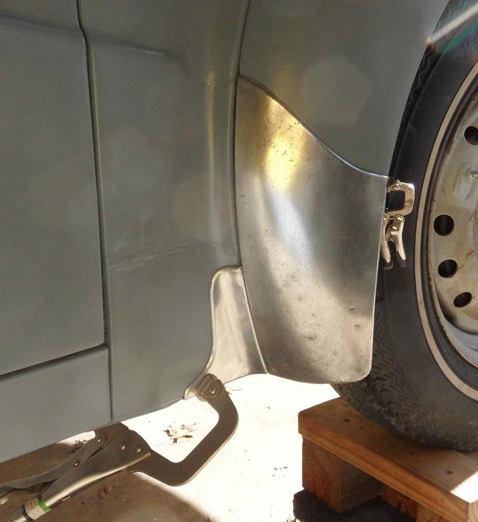

I got the new stone guards installed from 512 Classics over the weekend. To do both sides it took around 6 hours to get it right, well close to perfect. The biggest problem was with the bottoms being a bit to long. I had to cut the 90 degree edge at the bottom about 3/8" and fold over the bottem to get the guard even with the body, both sides were the same. Very little filling was needed. If I had to do it again I'm sure I could knock a couple hours off the install time. The thickness was greater on the 512 guards as well.
