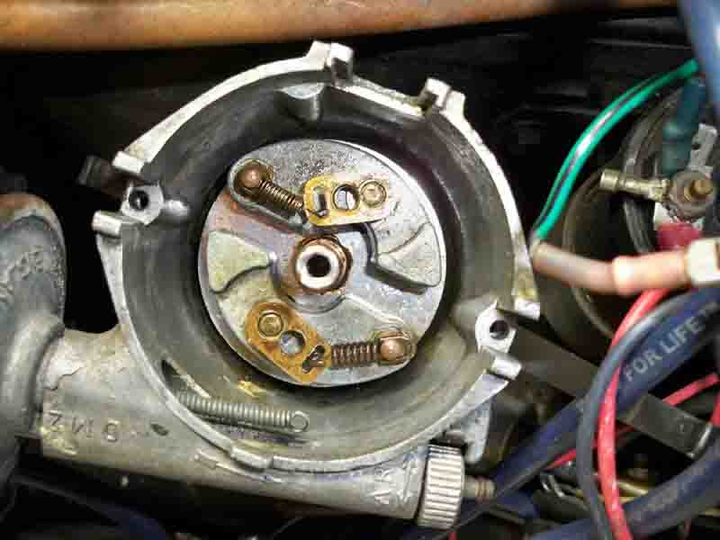

Does this look correct? particularly the way the springs and the weights are connected.

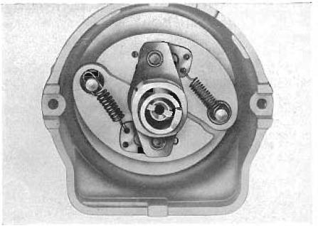

I'd have to find one to look at to be certain, but I believe the posts from the weights go into the center holes in the little phenolic pieces.

That last pic did it! as soon as i got the weights in the right holes you can see everything lining right up. I put the points in first to make sure it was going to run. then the Petronics went in. Just needs timing set now.
