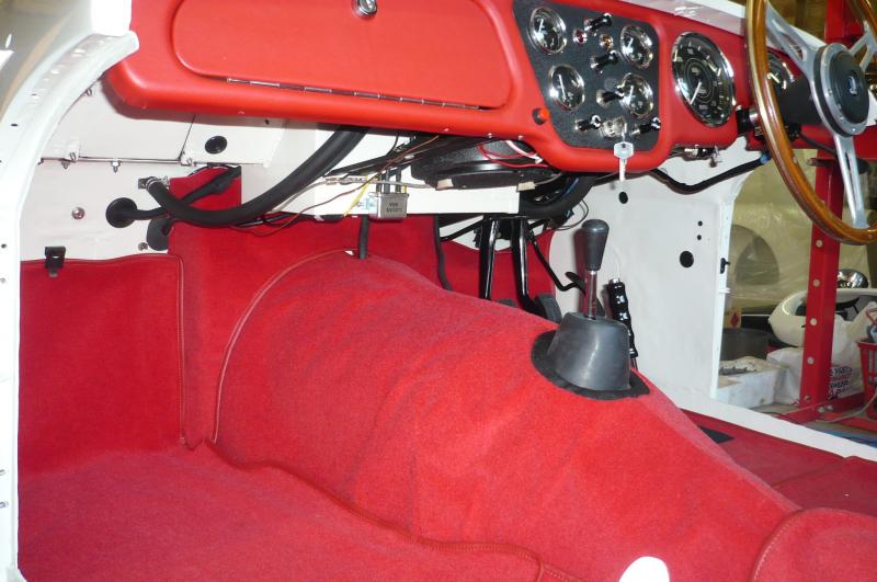

The last piece of carpet to replace in my TR3 is the bulkhead piece over the transmission tunnel. It's a JF Skinner kit. I'm going to have to cut openings for the tachometer cable, temperature capillary tube and the throttle on the driver's side. I have a couple of questions before I proceed:
1. There are two wire harness bendable hook/clips in the narrow "slot" between the battery box and the firewall. This is where the wire harness runs from the split behind the right-side harness exit (to the regulator, fuse box, RS lighting, etc.), to the left-side harness exit (wiper motor, coil and LS wiring, etc.) and also down to the dipper switch. Do I run the wire harness first, then cover it with the carpet, or perhaps cut slits where the clips are, attach the carpet, then run the harness in front of the carpet through the clips?
2. How to attach the carpet? Just glue along the top edges and allow to "hang" down? I know the bottom finished edge drapes the top of the carpet on the tunnel. If I cut the slits they would act as hangers for the carpet and the items passing through the holes, along with the footwell bulkhead pieces (hanging themselves from clips) would possibly keep it in place.
Any other ideas?

Thanks. I know the clips you're talking about and I have them holding up the vertical foot-well carpet pieces (and yes, the carpet is wool). The ones I'm referring to are the bendable metal ones that are welded about the car body. I did some more checking today and determined that they are way up at the top of that slot/opening, so that tells me to go ahead and put the harness in through there, then glue the carpet after that.
I do use a leather punch to make the holes for pass-through items, then slits if necessary. It makes for a neater application. I'm also using Weldwood contact cement, which holds very well.

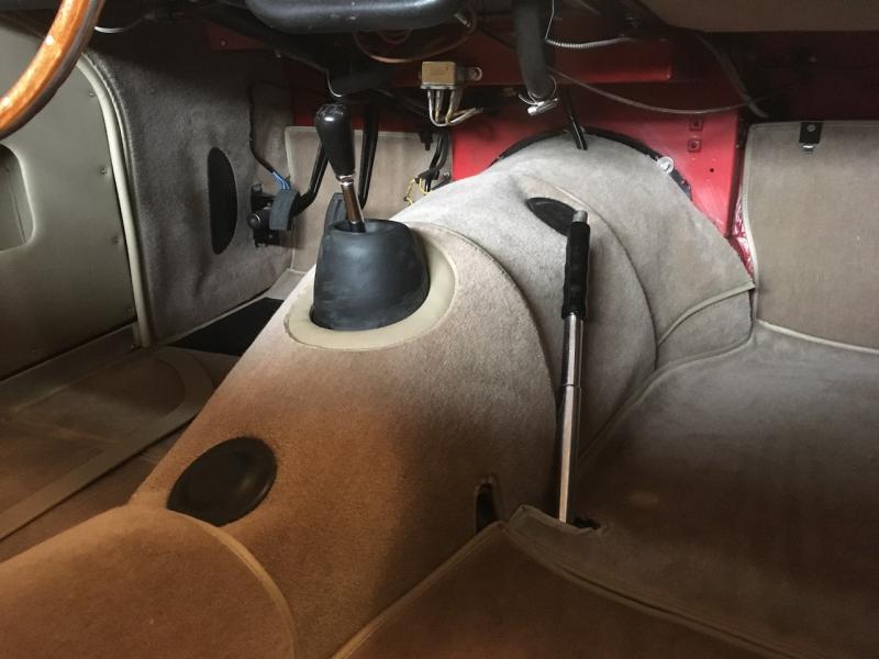

You said that is a J Skinner carpet kit. My one came as a one piece transmission tunnel carpet not in several pieces as yours appears to be. Could be the difference between wool and nylon sets.
I put the wires in first held by the "T" clips then the bulkhead carpet. There is a hole I had to cut for the accelerator pedal stop. Used some glue along the top edge and the bottom edge was held by the transmission tunnel carpet which was edged not a raw edge like the bulk head piece.

David, the carpeting for the early TR2-3s (mine’s a 1957) was cut-pile wool and the transmission tunnel was comprised of multiple pieces. When the -3A came out in late 1957 (as a 1958 model), the wool was replaced by loop nylon and simplified.
Thanks to all. It’s become apparent to follow the advice of putting in the harness first and then installing the carpet. The tabs up at the top of the “slot” between the firewall and the battery box will hold the harness up out of view, then the carpet can be glued along the top after cutting holes for the accelerator, tach cable and capillary tube. As I don’t have a tab on the underside of the battery box for the OD wiring, I’ll run it up to one of those tabs in the “slot” so it will be out of the way. It then will be behind the loosely-glued carpet.
