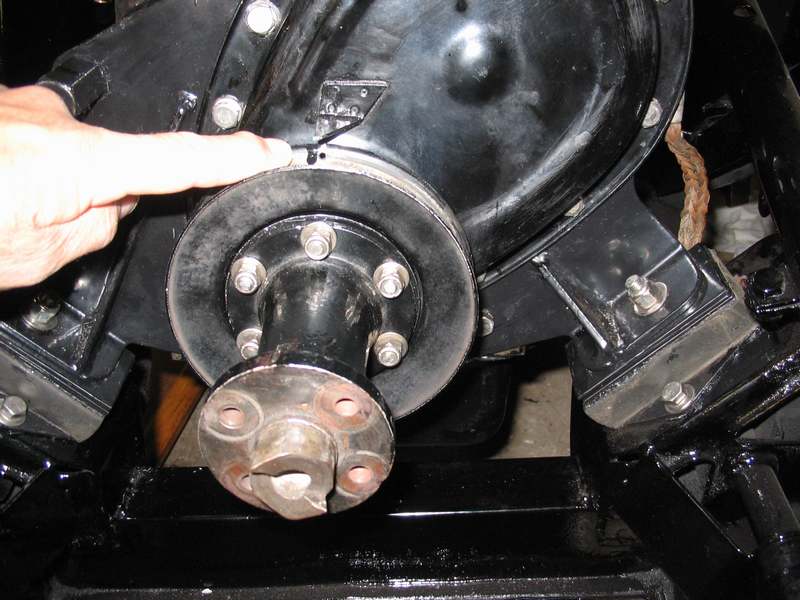

I changed the tensioner about 4 times during the 53 years that I've owned my 1958 TR3A. That's 189,000 miles from new. So I assume the time bewteen failure is about 45,000 miles. But in my case, it was not a "failure" - my tensioners never broke apart or got grooved through. They became grooved (2) by the chain links. This would cause a "rattling" sound as I took my foot off the gas and slipped it into neutral At this point there is no tension on either side of the chain and the loose part flops back and forth making the rattling sound. It did not rattle while accelerating, driving hard or while I was slowing down on hard compression. Each time I changed the tensioner, the rattle disappeared. I'm still using the original sprockets, bolts. timing chain, cam. pushods and rockers.
I restored my TR from 1987 to 1990 and I removed all the sound absorbing goo from the timing chain cover. I did not replace it. I can hear the tell-tale rattle better witout it. So it is an indicator for me that tells me if it need to be changed again. I used captive nuts made specially from stainless steel. All the bolts for the apron, fenders etc. are also stainless. It takes me a hour to have the bumber and apron off. I only ever changed the tensioner when I had other major stuff to do at the same time.
