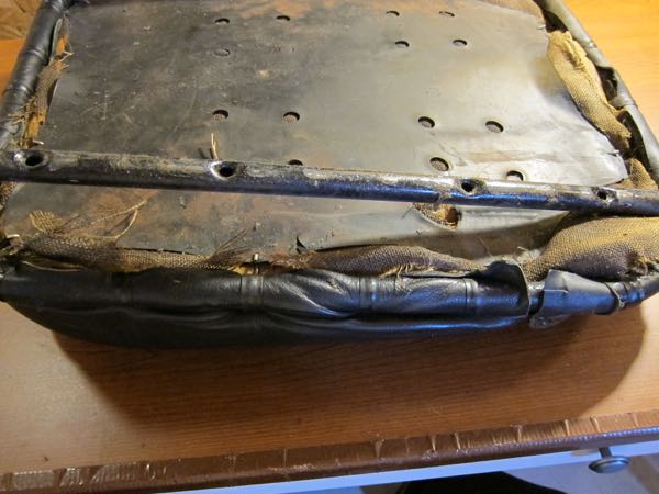

I've needed to do this since I bought the GT last summer. The seat covers are fine, but the seat bottom foam and diaphragms have had it. In addition, the driver's (right) seat base had cracked at some point, so the seats had been swapped side-to-side and didn't really fit properly. I'll put them back in the correct orientation once they're rebuilt.

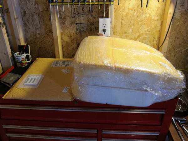

When I bought the car the seller included a new set of seat bottom foams and diaphragms, so I have the parts in hand to get them sorted out (other than the small bit of welding I'll need done on the driver's frame).

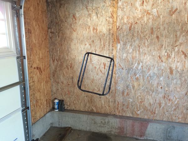

Here's my first bit of progress, have the seats out and the passenger (left) seat frame stripped and ready for paint and assembly.

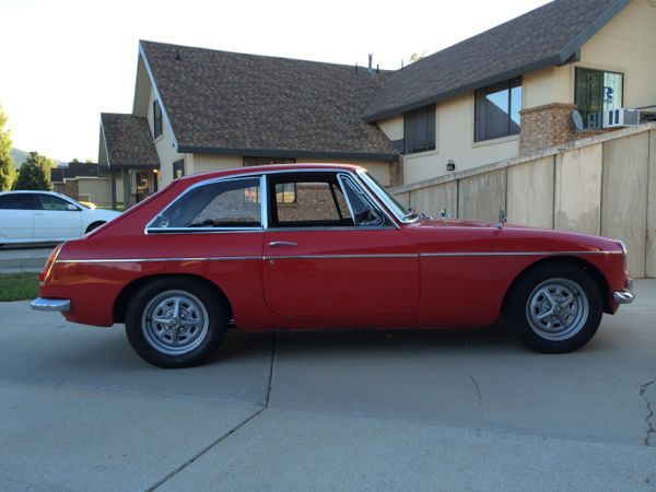

Here's the car. It runs really well, though I do have a few other small projects to sort out. Need to drop the gas tank and make sure it's not rotted (I have a spare), need to clean up the wiring to the fuel pump, and need to replace the clutch cable.
The car is rougher than the pics show, but it's a nice driver for now. It's not a long term keeper for me, just something to drive while I'm finishing up the Bugeye.
Shortly after I bought it:
After I swapped to disc wheels, after numerous flats with the wire wheels:
PAUL161
I always like the GTs and wouldn't mind owning one. Be a nice cold weather car. :encouragement: PJ
Flash_Harry
Nice looking GT, Drew. I like ours, too, and it's not a bad warm-weather car, either! Cold down here is anything between 30 and 40 F.

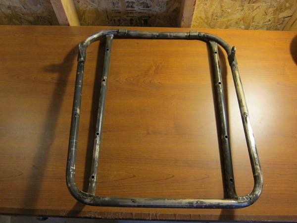

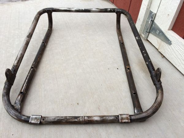

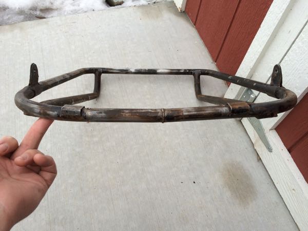

Drew do you have a picture of the bottom rear of what would be the correct left side seat frame?
I'll get a pic for you, probably be a couple days before I can get out to the shop.
drooartz
drooartz

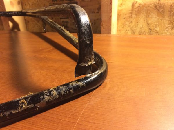

Seat pics as requested. As far as I know, this is the LEFT seat -- someone please correct me if I'm wrong.
From the top
Rear edge (sorry about the finger choice for propping it up)
Bottom
Stewart
Thank you Drew I think you just saved me some bucks. I thought my seat had a dpo repair to it but it looks like that's the way they came.
Funny, I was wondering the same thing with my seats. Nice to have confirmation all around. :thumbsup:

Drew, Your very fortunate to have the new diaphragms and seat foams. That is quite a savings. Is that all you need to do to get it running? PJ
drooartz
drooartz
Pretty much. The car runs really well, very strong engine. Other than the seats I need to drop the gas tank and make sure it's okay (I have a spare tank on hand) and need to repair the wiring to the fuel pump, as it was bodged by a previous owner. Small things, but takes some time to get to it. Still, should have it all buttoned up before the we get to the driving season -- mid March is about the best you can hope for around here.

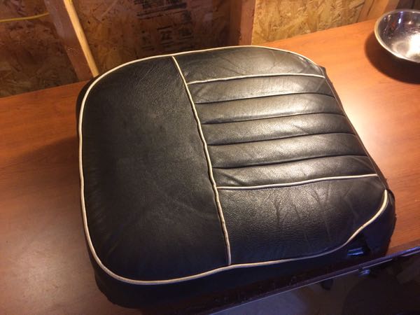

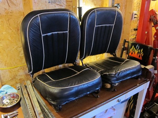

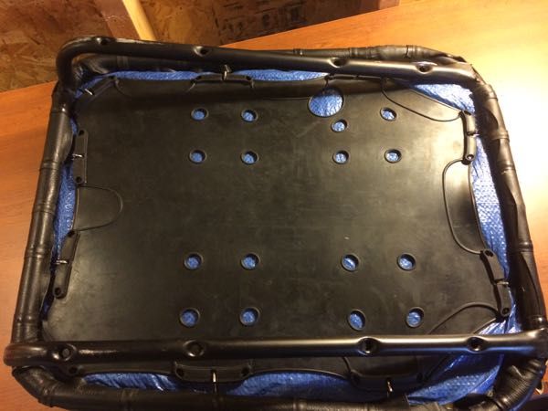

LH passenger seat done!

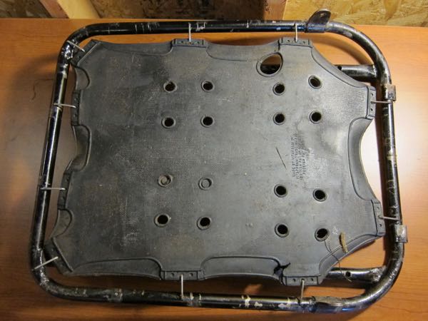

Finally had some time to work on the GT seats this past weekend. Was able to finish up the passenger seat and get it all reassembled. Need to get some new bolts and I'll be able to get it reinstalled in the car. Stretching that rubber diaphragm is a bit of a pain to be sure, but it all went together fine in the end.
The original seat foams had some sort of burlap layer between the foam and the diaphragm -- as I didn't have any of that laying around (and the originals were quite shot) I used a bit of blue tarp instead.

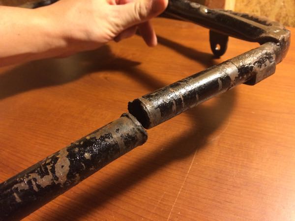

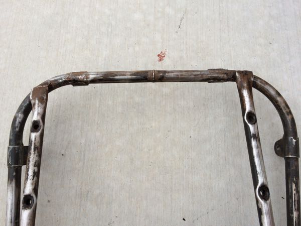

Cracked driver's frame
I also was able to get the driver (RH) seat bottom stripped down. I knew it had at least one crack, but also discovered that it is cracked in half at the back of the frame. I've got to get it to a friend who can weld to see if it's salvageable. I hope so, as I really don't want to have to track down another one.

Re: Cracked driver's frame
Looking good, Drew!
If you do need another seat frame, I'd be willing to bet that Bob here on the forum (bob6bgt) has one.

Thanks, Mickey. I'm going to see if the one I have can be repaired, but I'm not sure if it's too far gone. Bob's a good thought on a possible source for a replacement if needed.
Platinum
Along with the "dreaded crack of doom" on the doors, the pre-'68 seat frames cracking was (is) not a rarity. They should be fine when re-welded, Drew.
And I guess you've done battle with those hooks on the seat bottoms already. Be aware they can BITE if ya have flesh in the wrong place while trying to install 'em.
Good to know on the seat frame. I have some friends local who can weld, so hopefully won't be too hard to sort.
And whoever designed that rubber diaphragm and hooks process should be boiled in motor oil. Geesh. Solution was a heat gun and needle-nosed pliers, and some patience. Took a couple tries through (and one torn diaphragm that I will have to replace) to get the job done.
