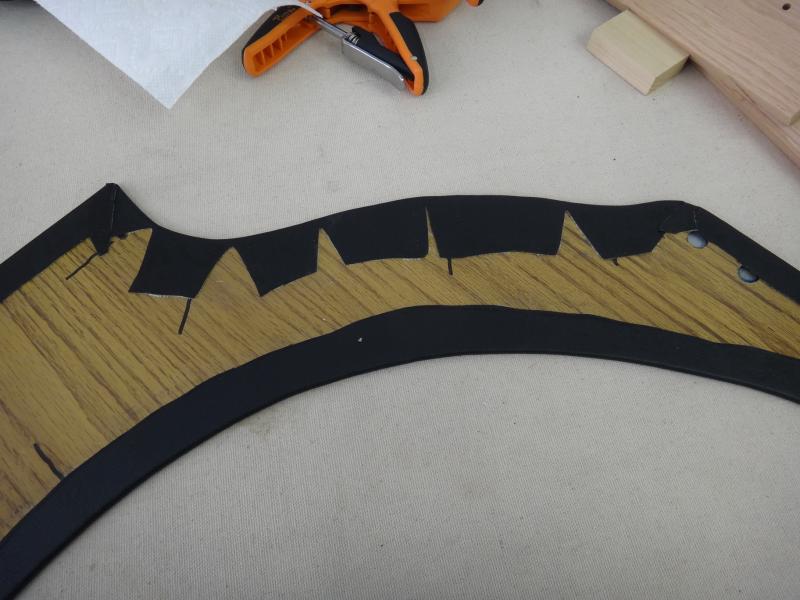

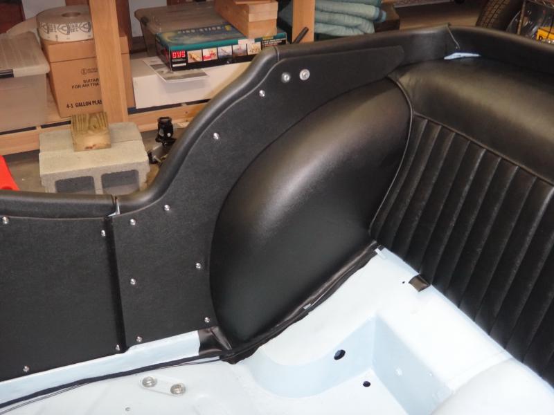

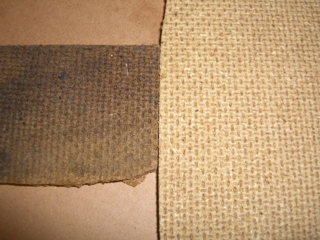

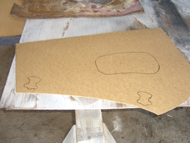

I thought I would post to show where I am at with my car and ask a couple of questions about fastening to that hard board the panels are anchored. The board I am using is surprising the same or the same as the 1950ties stuff. I bought one of those staple guns at HF that shoots ¼ staples. My concerns are filling the door card with staples like was done originally or to use more glue and less staples because my fear is at some point towards the end the board will break because of all the staples. The fiber board kinda looks like the stuff John used. I am a carpenter, but I have never used this product or work much with light weight material. I did my seat frames with ¼ plywood and have a feel for that plus they were done originally with plywood.

Steve, that's looking great!
I know the factory cut out those side curtain mount holes...but I'd probably not worry about them. They never seem to be located quite right and I never saw the purpose anyway??
Skinner used glue in some areas and staples for others. Where they stapled they used plenty of them. Even with my removing and re-stapling I didn't see any weakening of the fiber board. I think either glue or stapling, or both, will work fine. The only area I might be inclined to use both would be around the glove pocket. The pocket is not pressed against the door metal and also sees a lot of use...so both glue and staples would be appropriate. Around the edges is held against the door, so it naturally gets pinched.

I rebuilt all of my interior panels and only used a few staples where the glue didn't get a good grip. Other wise it was only Weldwood Contact Cement. So far, so good.

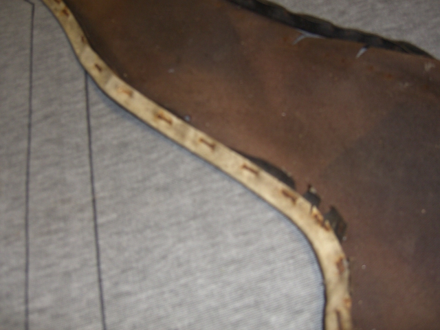

The reason I asked is some of these original panel cards were stapled on 1 inch centers!

My original panels had staples as well. I experimented with staples of different lengths but wasn't pleased with the results. I was using Masonite which I had a ton of around here. It is harder than what was used originally so the really short staples wouldn't hold very well. With the ones that were slightly longer the points would protrude from the other side. Since I wasn't using any padding, they would stick into the material leaving a dimple. Didn't want that. So the contact cement worked good.

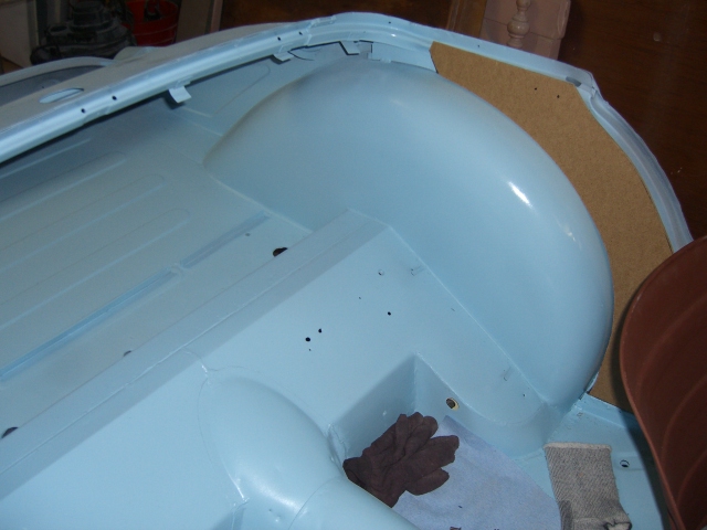

I found the fiber board at HD, RC64 and it looks and feels exactly the same as the original stuff and that surprised me. I could not resist using it; it warps easily; if it is in the sun it starts to curl and I am sure it will hold water by looking at the old stuff.
Masonite is more than likely the improvement board over this stuff because it lays flat and resist water, and that is what I was going to use. Here the Masonite is 22.00 a sheet and this stuff is 10.00 and recommended for shelving. it is the cheapy and hopefully it will hold staples.
