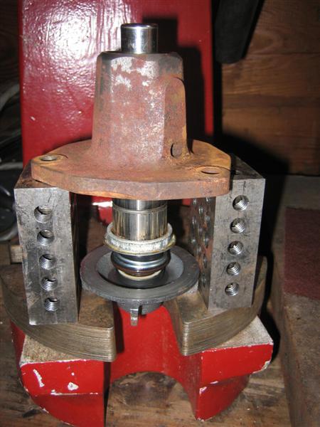

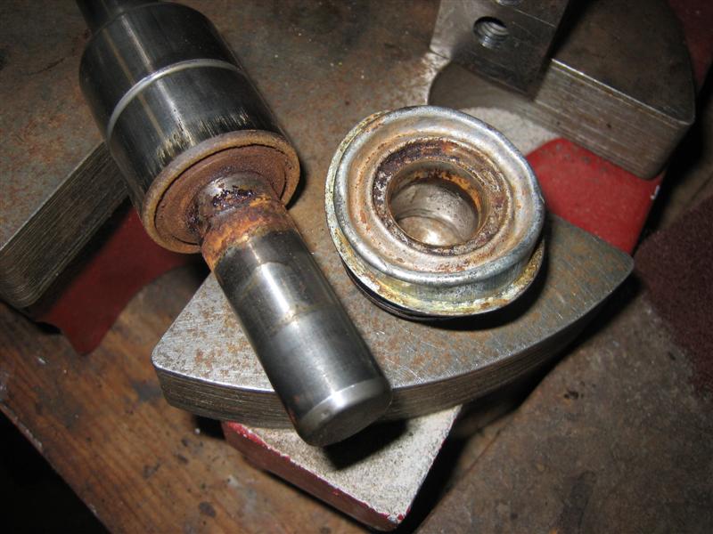

I've rebuilt several. If you have access to a press, it is an easy and straight forward job. The hardest part is tracking down the bearings. The part that seems to wear the most, aside from the seal, is the steel shaft. It tends to erode in the middle.

I have seen it done without a press by using a purpose-made tool to press out the shaft. Here is a (tantalizingly out-of-focus) picture of said tool taken from the video of the tech session that might give you some ideas:
I do recall that it was the availability of the bearing that was an issue in the past.

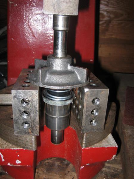

Well I got it fired up, but the old back up water pump leaked also, so I shut it down. If I actually do rebuild the pump, my question is did you guys pull the impeller off the back or just push the guts of the pump out front to back. I had 2 old trashy pumps that I push the guts out this way, but the inner snap ring gets toasted in the process. It is probably not a big deal because I can just get another small inner snap ring one. Moreover, if rebuilt this way it looks to me that I should be able to leave the impeller on, put a new snap ring in and push the complete assembly back in the housing from the back, put the big snap ring on and be good to go. However, I do see a large gap on the shaft between the rubber seal and what is called the spinner washer and that does not look correct. Perhaps the new seal is larger and would fix this. Anyways before I take my other 2 pumps in and have the pulley push off and if advised have the shafts pushed out from the front to the back maybe I can get some input. I was also thinking about calling the rebuild guys to ask questions and buy parts but I do not want to waste their time.

Well I talk to Harold the guy Tomshobby suggested, and he is totally cool. He has been rebuilding water pumps since 1957, and we talked for about a ½ hour about water pumps. I am only guessing, but it seemed to me he has a larger business with a staff and we were talking about water pumps just for fun. I did not realize that the housing and seal need to fit square or exactly on the same plane with a small amount of preload on the spring on the seal. He also recommended that I put the housing in a lath and turn the surface true and flat where the two meet, but the surface looked good on one of my old casings, so I used it without turning it. Anyways, he sold me a seal with a metal back that worked fine for a couple of dollars. I reused some bearings that I had, but he called a buddy and that guy had some bearings that would work, but the bearings are narrower so the distance piece between the bearings needs to be longer. Again, Harold is a great guy with a wealth of experience, and I actually believe he enjoys helping people, you do not see that every day.
