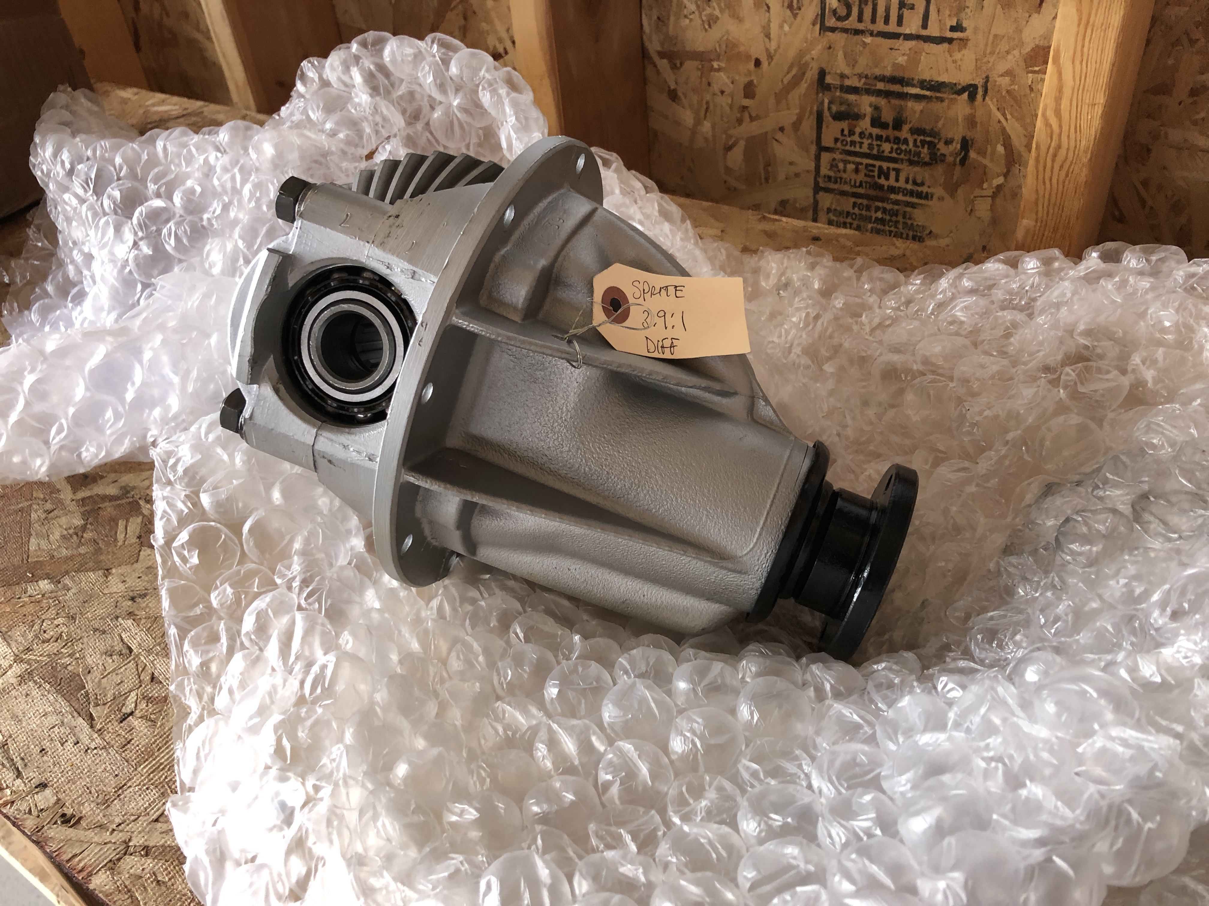

Took some waiting, but the 3.90 diff finally came in. Car is up in my lift so hopefully in the next week or two I'll get the rear axle off and can get to work.

Will do -- though with the diff this is a fully built unit from MiniMania. Just drop it in and go. This is one of those instances where I happily traded money for time saved.

you'll still have to do the pinion though right?
drooartz
drooartz
Nope, it's a full pumpkin ready to bolt into the car. Did the same for my Morris last year (same diff as the Spridgets). Comes fully ready to go. Not cheap, but just pull the axles, remove old unit, install new one.

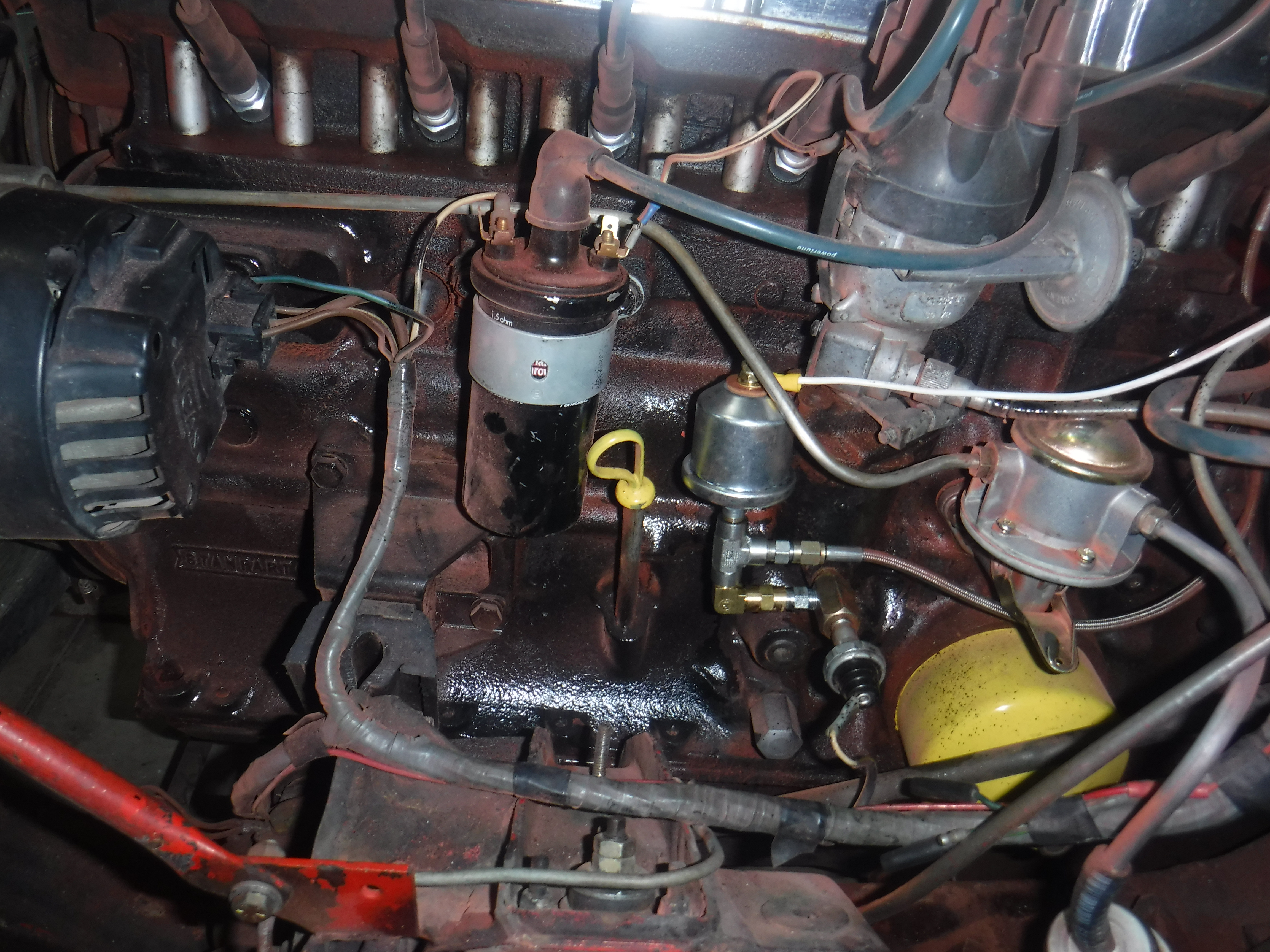

I am doing a Triumph GT 6 1972 getting ready for paint, the car is new to me and has not run in years. I started with tires ins. and DMV and drove the car all the simple stuff change the oil replaced gas line cleaned and sealed the gas tank new battery new fuel pump I still start the car now the glass is out and doors off looking for rust in the normal places. At this point I am checking all the elec. and wires connections grounds to make it all work again. The car is mostly sanded some rust on the rockers panels not bad. Before it goes to paint I will do the brakes and what ever. I have another diff. and trans ready to go in so it is remove and replace little down time. I will do new U joints at that time. A fun little car to drive will never be a TR6 1973 that I also did years ago our second car to drive club runs fall color etc to the store.
The motor will come out for paint as the PO put under coating on the firewall frame well whole front end. No windscreen but still drove it down the street.

On the diff, here's what I received from Mini Mania. Complete, painted, setup, and ready to install. Ship my old one back to get the core charge refunded.
