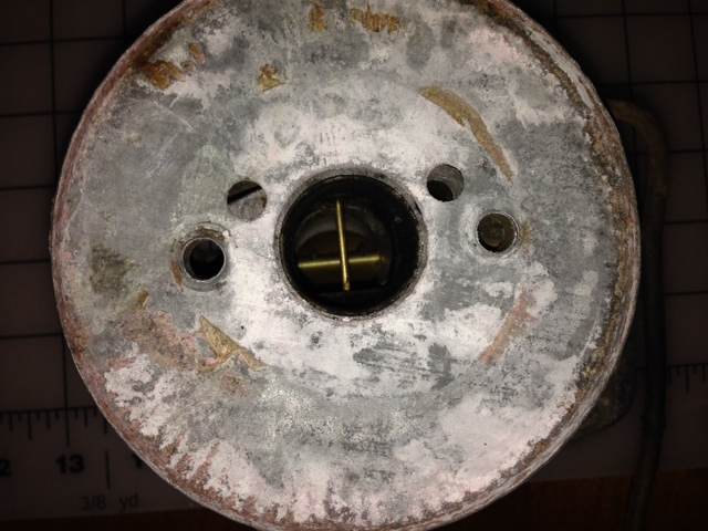

So I am running a 948 with 1 1/8 carbs. The 1 1/4 filter bolt holes are very close in spacing, but they have 2 small breather holes (vs one for the 1 1/8). So you would have to fill in one hole and open up the remaining breather (see picture I placed them over a 1 1/8 carb). I have a set of pan air filters for the 1 1/4 carbs that I pan to do just that when I run the car on the road and use the stock Coopers for show. They use a John Deere 110 air filter that you can get from NAPA. As an alternative I guess you can just make your own filter plates and use what ever filter you want. AH spares in the UK has lots of good parts. If you have problems with your Moss parts send them back, they will make sure they work or refund you.
