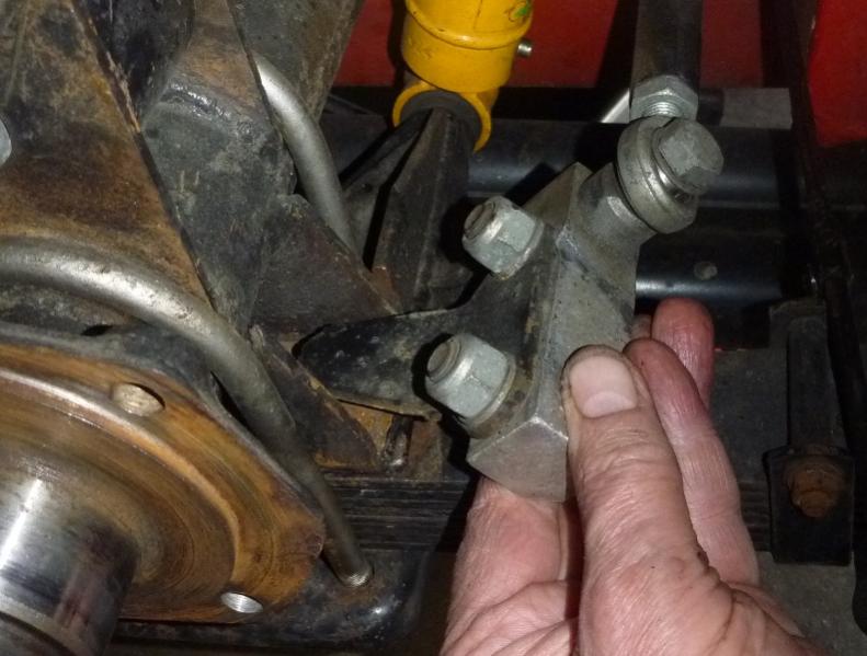

Just noticed my panhard rod mount at the axle has broken the welds and is non-functional.
In normal (non-race) driving, does the panhard rod provide any benefit? I know what it's supposed to do, just not sure I noticed any difference with it broken.
This is a Cape International "uprated bar" with a Heim joint at the axle end. This may have caused the break, as the stock setup has rubber bushes at both ends.

Rear spring toe-in isn't an option. Will re-weld the bracket and either re-install my stock panhard (if I can find it) or modify the end of the Cape item to again use the rubber or poly bushings.

Steve,
I assume since you broke a poly bushing on your Panhard rod, you must have repaired it. I discovered this afternoon that mine has broken the same place yours did. We're you able to repair without removing the axle, or did it have to come out? Did you do any reinforcement?
steveg
steveg
Steve,
I had to modify my rear shock mount to add the "ear" for the panhard rod. See:
https://www.pbase.com/stevegerow/image/154242713
Was not able to re-weld the stock mount without removing the axle.
