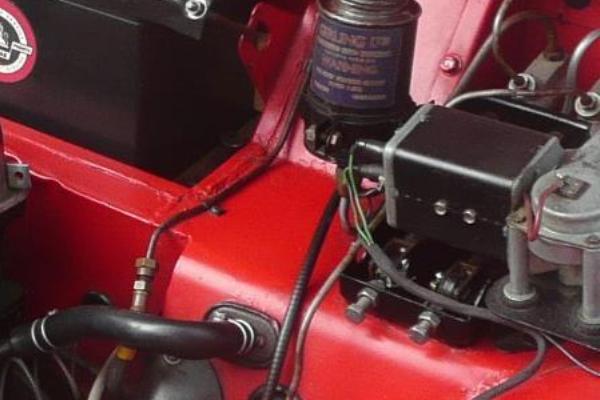

My 59 would not have had stop bolts originally (perhaps yours didn't either) but I added some just to take out the last bit of slop in the pedal action. I set them to stop the pedal just after it had ended its useful return travel.

They are just 1/4" bolts with two nuts to lock them, if you have front disc brakes you don't need them.
Graham
I have the disc brakes so that's good to know they are not needed. Do you think that if the MC's are lightly honed to clean them up, that installing rebuild kits would be effective rather than re sleeving the cylinders?
