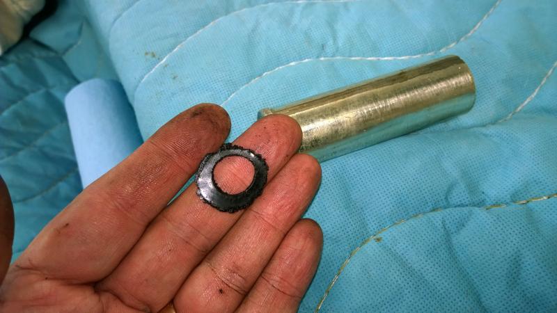

Doesn't seem like the big three or even Moss Europe carry the flexible washer/seals for the Brake Fluid reservoir. I saw that you can buy the whole can for around $70. Was wondering if any of you had found something that works here. I went down to NAPA, and they started to look at O rings, and sold me a couple of copper washers. Went down to a hydraulic hose repair shop, but would spend a fortune on a special order sheet of brake fluid resistant material to make my own.

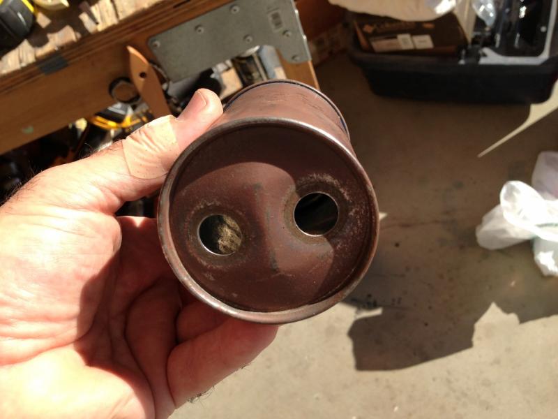

Thanks Berry. The hole is 1/2 inch. I don't know what the outside diameter was. Also, do you know if there was one or two gaskets? The one I found on disassembly was under the tube that creates the second reservoir. Per below. There could have been more, but everything was pretty mushy/disintegrated.

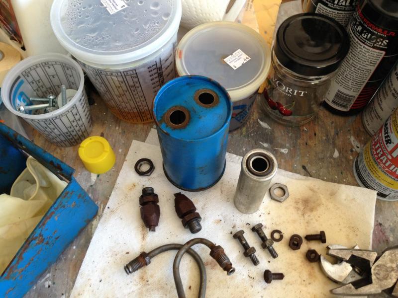

Sorry I am so late to respond. I too had concerns with rubber, but had several 'good' reservoirs' that needed married to good pipes. -And I hate to buy something new when all they really need is a good cleaning and a washer. Going off memory, I used copper washers. I looked through my pictures and can't find any of the MCs, but know it was trial and error until I was able to get them tight enough to not leak. I've been driving it for over a year and still no leaks. A rubber gasket at the top is also important as fluid kept wetting the top lid and making it look like there was a leak somewhere.
I'm told the fluid level should be below the internal baffle, so you can tell when something is leaking, but I keep my fluid level just above the baffle.

Bruce, I purchased EPDM o-rings from McMaster Carr for this purpose. They were a little tricky to install (they are a bit fat) and they can't be tightened and crushed like a copper or aluminum washer can. If I were to do this again, I might consider using a soft copper washer for sealing up the can bottom fittings. With the o-rings, the bottom fittings can move a bit - soft metal sealing washers would be more solid. My reservoir is leak free (after about 6 months of use). I purchased about a hundred o-rings for about ten bucks. Let me see if I can find them. If so, I'd be happy to send you a few to try.

It has been awhile, but as I recall, both fittings had a fiber washer under the head of the fitting; then the "rubber" washer was between the inner chamber and outer. On the outside were just star-type lockwashers and nuts.
