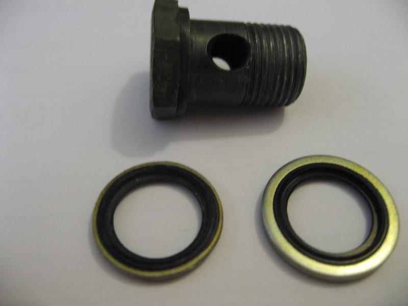

The fiber gaskets for the banjos seem to leak after on for awhile. I use seal washers to slve this problem
attachment.php
They are British Bonded Seal washers, part no.9900 from Brennan Industries. One washer needs to have the OD reduced to fit in the recess of the banjo. I made a fixture to accurately grind the washer to the size needed.
I make these up if you need a set or two!
