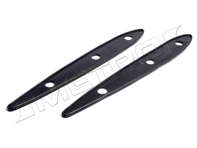

I used the ones from Metro. (Link Below)
Thanks,
Duane
'58 BN6
https://metrommp.com/?f=product_list_for_vehicle&VehicleYear=1960&Make=AUSTIN&Model=HEALEY 3000
attachment.php

I used the Rubber ones from Metro too.

Thank you all for the suggestions, I'll probably go with the rubber gaskets. I was not aware of their availability.
