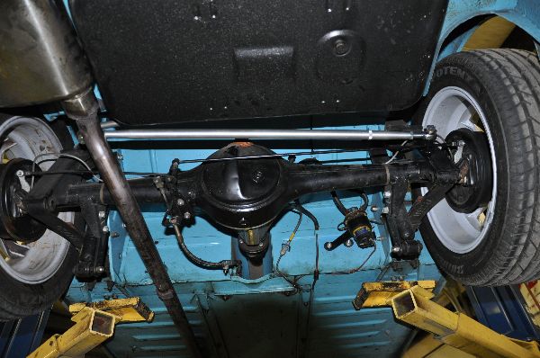

I want to thank all of you that responed about a panhard rod. After looking at alot of photos and reading all I could, I spent about $100 for DOM tubing, some 1/4" X 2" cold rolled flat bar, acouple of rod ends and a handfull of grade 8 bolts. Started on the project last week in the evenings working in the driveway and took Little Red into my shop today were we have a Mig welder. Worked at it for about 5 hours and enjoyed every minute.End result--NO TIRE RUB. It also really seems to glue the rear down. I'm a happy camper.
Gundy
I like the way the panhard tidies up the rear myself.
This is my Speedwell Engineering panhard rod installed.
