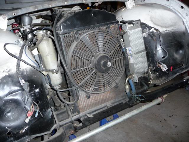

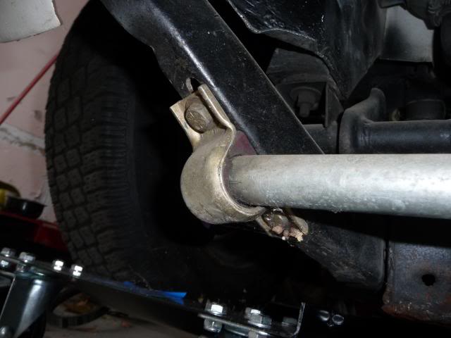

I have one on my 60 TR3A that mounts to the bumper support brackets. I know the brackets are different for the earlier 3's though...but, if you want some pics, I'll see if I can dig some up. Mine is an Addco bar as well.

Tush, I would love to have a couple of pictures of how yours mounts to the frame - don't kill yourself doing this as it appears to be a little more difficult than I first thought.

Hi Jim,
Here's a few photos from when I got the car.
Cheers
Tush
CJD
Tush's car has the later style bumper brackets, which are much more substantial than the early brackets. On the later cars Tush's is the way to go.
