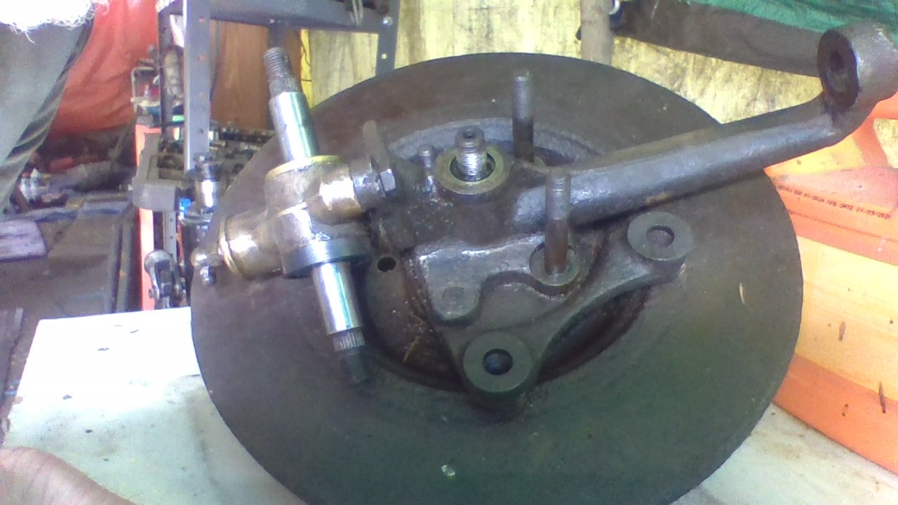

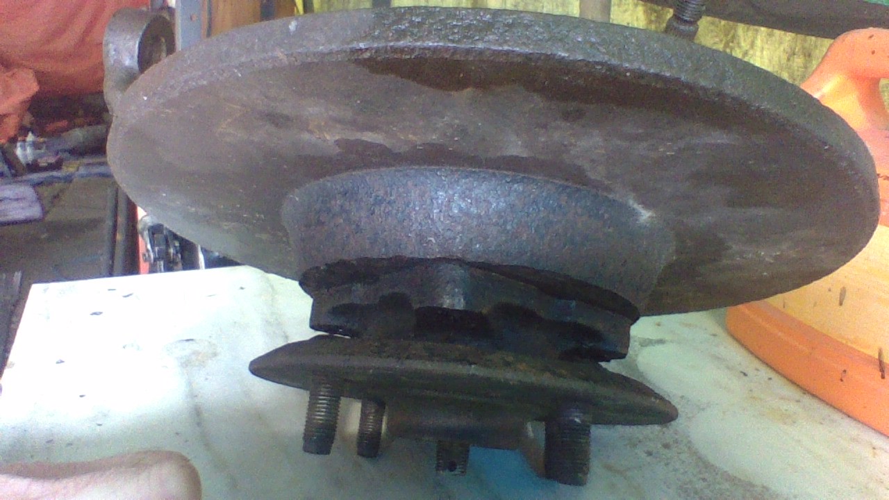

I have the assembly on the bench. I have removed the 4 bolts that hold the hub to the disc. What is the best way to remove the hub?

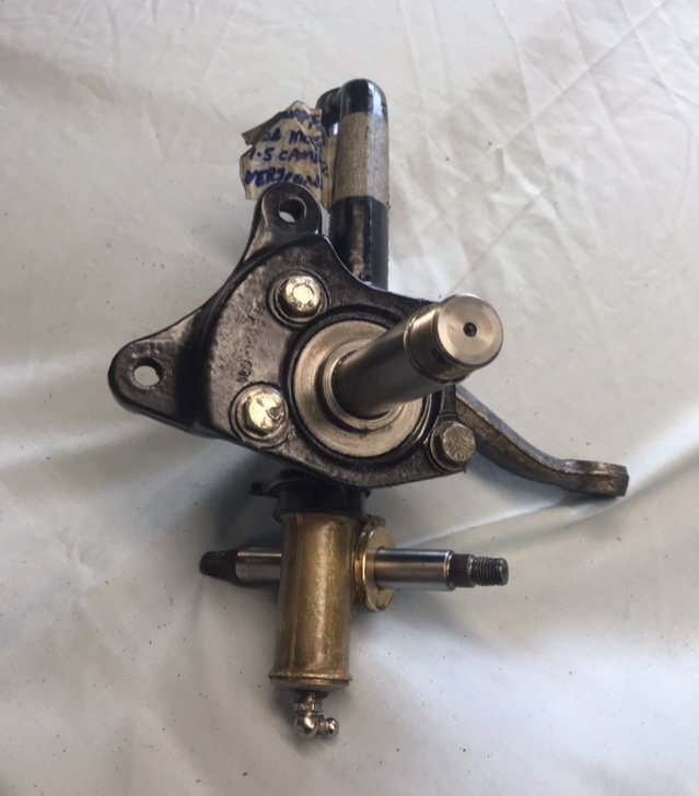

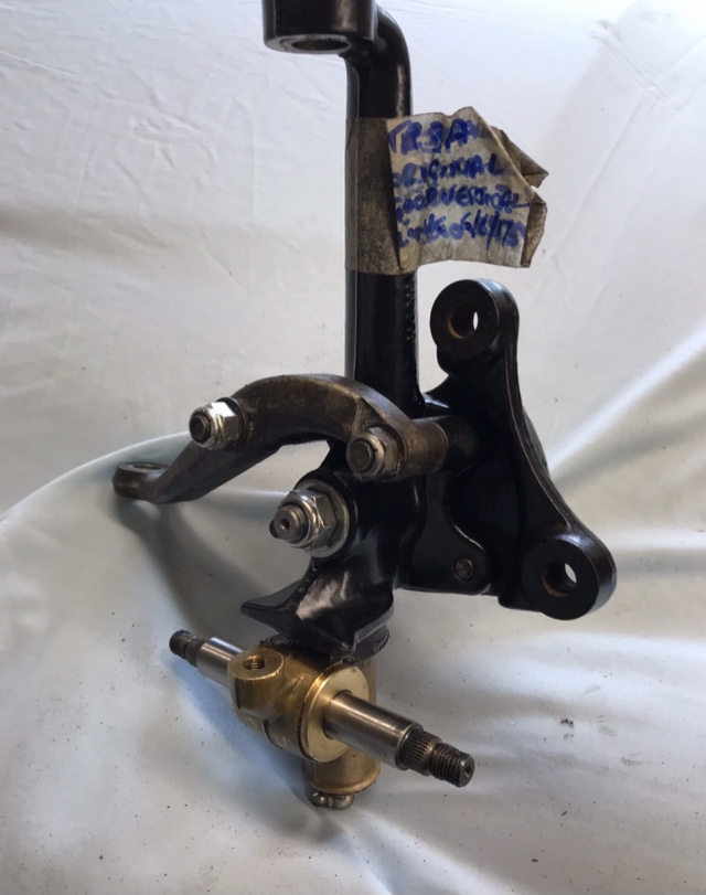

Hit it where? I'm trying to get the vertical link off but in order to do that I have to remove screws to the hub and I can't access those screws with the hub on?

Once you remove the castellated nut on the stub axle (which it looks like you have) the hub and rotor/disc should simply slide off.
CJD
You must remove the wheel bearings. On the opposite side from the nut you removed, there is another nut with a cotter. The other end of the stub axle...under a cover. Remove the nut and the hub will pull off the stub axle with the wheel bearings and a lot of grease. Then you can unscrew the trunnion and work on removing the stub axle.

The castellated nut with the cotter has been removed and the nut on the other end of the spindle has been removed. The four bolts that hold the hub to the rotor have been removed. The hub will not budge? Why is the hub frozen to the rotor with a death grip?

Then the hub, with the disc, bearings, and seal...should slip right off as a unit. It sounds like something in the seal/bearing area is locked up. Does the rotor/hub turn in relation to the vertical link?

Yes the rotor hub spins freely! I may have to try and rig up another puller of some sort as the 2 prongs on the puller are not able to grip the edge of the hub properly???
