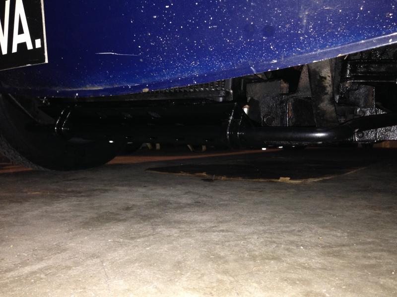

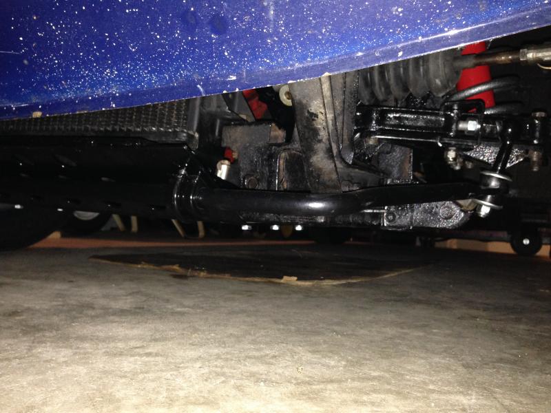

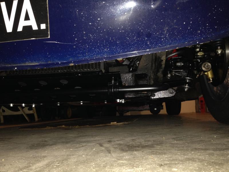

HAWAIICJ
Not a TR3 but a Rimmer ft swaybar on a TR4 with TR4A links and lower arm brackets.
Edit: The mounting is the Moss ft radiator guard and the clearance from the bar mounts is 4.5" to the floor. It looks low but the bar hasn't touched the ground yet during extensive road testing since the mechanical restoration.
