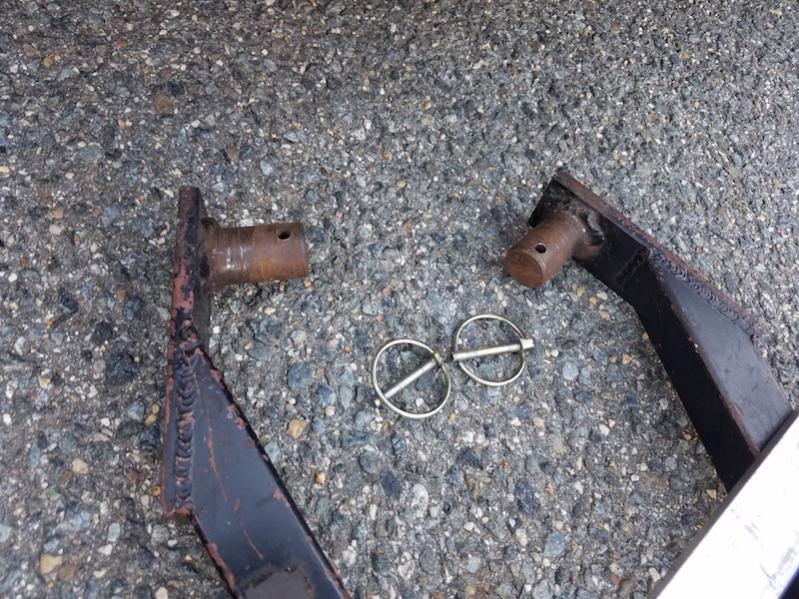

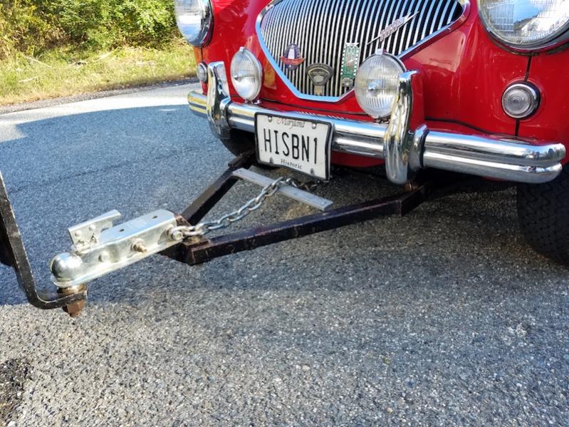

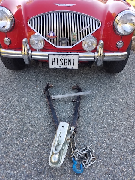

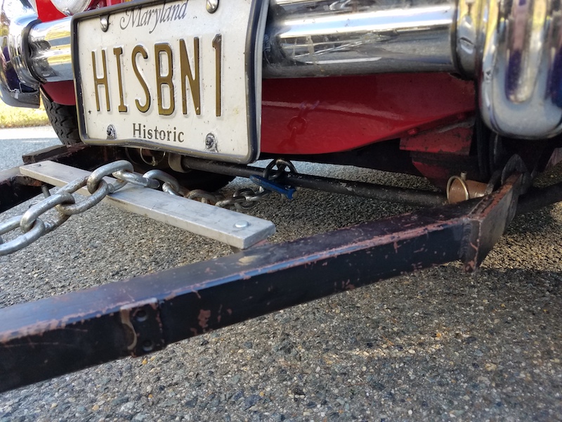

I have one and will try to post a pic tomorrow. it is a standard folding bar the ends of which I had modified by having short lengths of round bar welded on which slip into tow eyes that bolt up to the frame left and right. It takes about 5 minutes to deploy and the car tows wonderfully.
Michael Oritt
TH--
I hope these four photos are large enough for you to see how I attach the tow bar to my car.
I bought the tow eyes from DW but there are probably other suppliers whose eyes are the same or similar. I cannot remember where I bought the tow bar but you will find a similar one at Harbor Freight. I modified it by having solid steel bar stock of appropriate diameter to fit the eyes welded onto the ends of the tow bar, with holes drilled in the ends to receive the spring-loaded linch pins. Once the bars are in the tow eyes I set up the light cross bar and rig the safety chain around the anti-roll bar, then hook up to the tow hitch.
I do not tie down the Healey's steering wheel but rather let the car follow along and it tracks perfectly with the front wheels moving to left/right on turns on their own. I DO NOT GO INTO REVERSE!!!

In inspection of the tow bars available, I am having trouble visualizing how they attach to the frame using the existing threaded mounting welded nuts. Moss sells the attachments that fit the frame but the commercial tow bars have a different configuration.
Michael Oritt
TH--
If you view the pics in post #3 you'll see that I cut off the ends of the collapsible tow bar and had solid bar stock--probably about 1" diameter--welded to the ends of each leg. The bars slip into the tow eyes from the outside and are secured with lynch pins. I'm not sure how to describe this more clearly but if you like give me a call at 305-793-9467 and I will walk through it with you.
